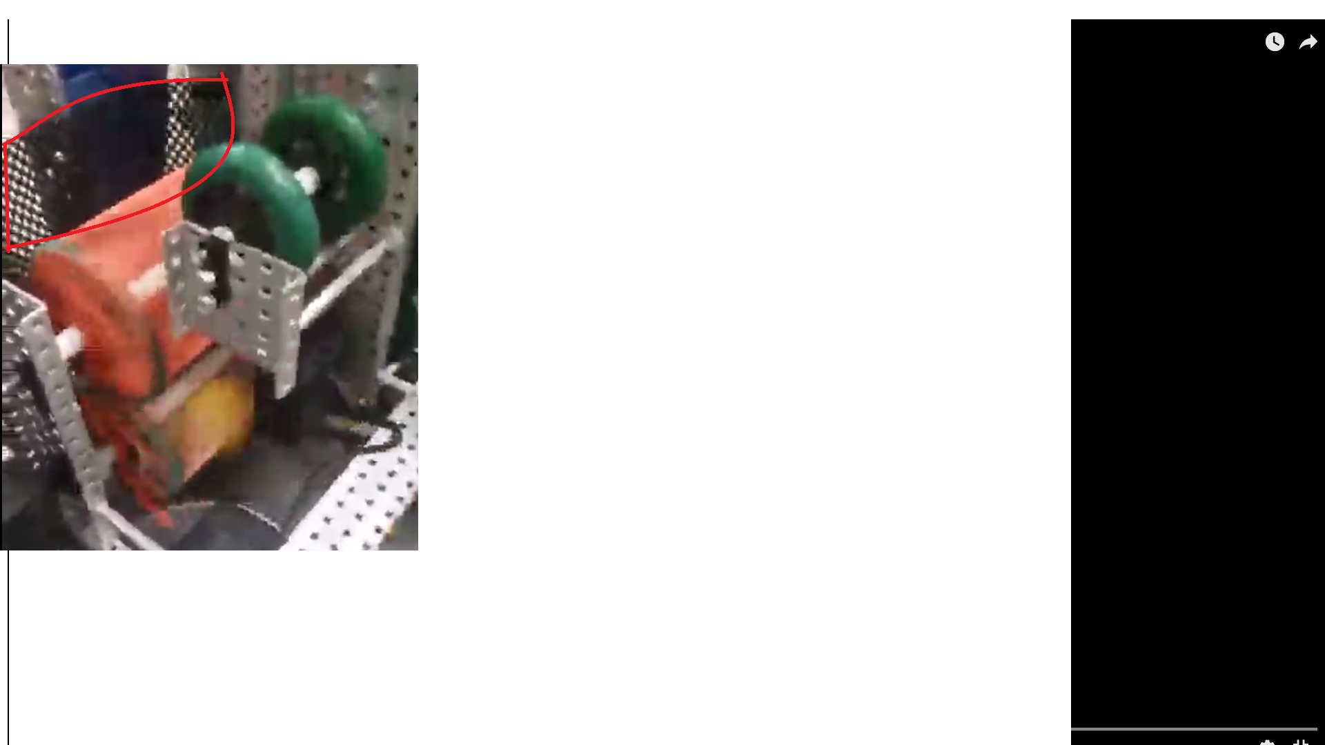

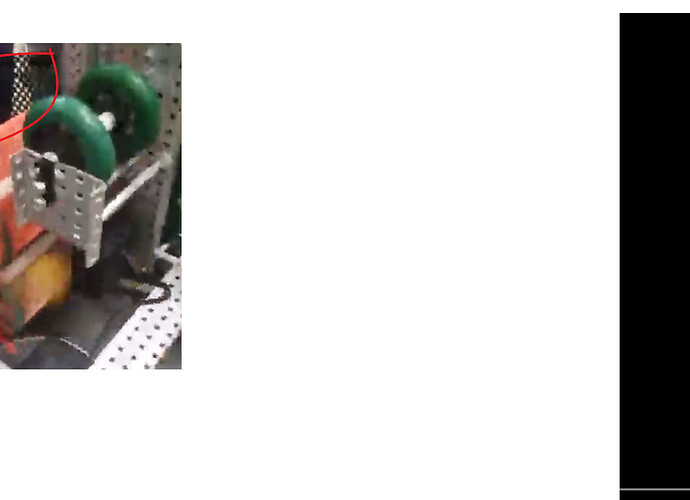

Hello! We are new to vex and we want to know how does this black material that everyone uses is called? What is the reason that everyone uses it? Can we build an intake without it or what we could use instead?
This is the VEX supplied material: Anti-Slip Mat (2-types) - VEX Robotics
Any commercially available equivalent is OK.
That’s anti slip matting, like @nnolte said, you can find it commercially at a cheaper price and it is still legal.
Also to answer your other question it is possible to build an intake without the matting, most teams just find their intakes better with the matting as well.
While this is true, a ref told us at our regional comp last year that any piece needs to be smaller than the mat that vex sells. If a piece of the mat is bigger, its technically not identical to a vex sold product
Clarification: A piece can be the same size as the Vex antislip. It does not have to be smaller.
You can build an intake without it but the grip it provides is hard to match with alternatives
It cannot be bigger. Last year at Worlds during inspection, they had us have the teams cut their matting to pass inspection. I told kids to just go back the pits and use zipties to create a seam to connect them back together.
I was unaware of this limit. Does anyone know a good way to check if your matting is of legal size? We have a lot of matting in different parts of our bot.
What action000 is saying is that you can not use a single piece bigger than the mat vex sells. You can use as much as you want, just as long as the pieces you are using are smaller than vex’s mat
