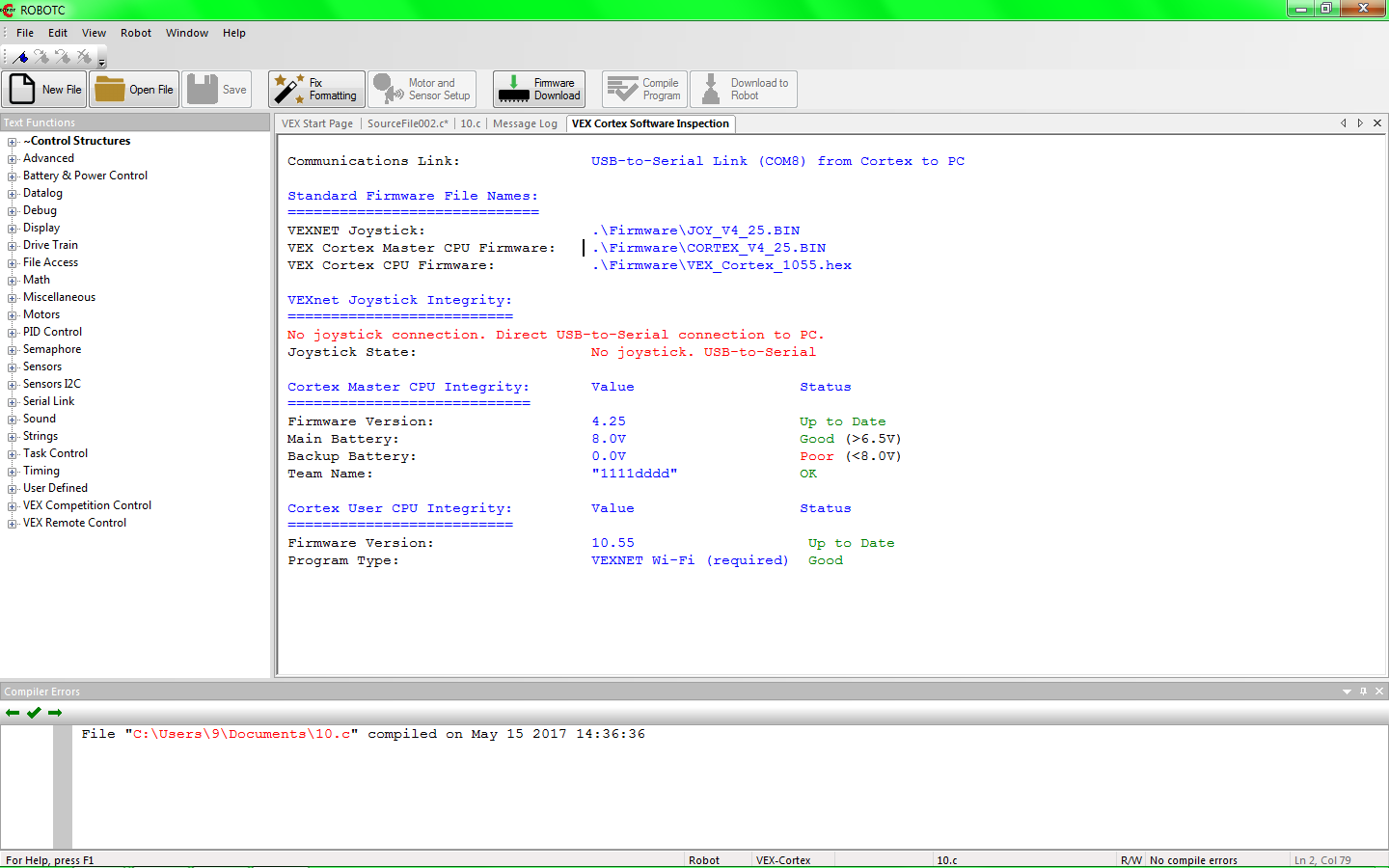

Hi everyone! We have VEX cortex, vex joustick and two black VEXnet keys. On VEX cortex and vex joustick i have frimeware version 4.55 and last version of CPU master. I need to connect them. I download with vexconnection by vex competition or USB. My robot name is ok, wi-fi link is available, but with keys i can’t connect them. With AA USB cable i make it easely. What need i to do to connect by keys??? Attached file is my code and frimeware cheks.

I’ve heard that the black Keys are less favorable because they have the same frequency as wifi, which makes them really buggy. That may be the problem.
I’m not sure if this will work, but I think this is what my brother did to connect the two keys.(This is with the white vex net keys.) Plug the orange cord into the cortex and the joystick and wait until the brain has at least one green sign. That is how I remember to connect the two.
That’s right :slight_smile:
Also, correct me if I’m wrong but with the 4.55 firmware version on the cortex/joystick the black vexnet keys aren’t compatible. I thought i heard that somewhere…
The black vex keys have more chance of failure.
Black keys are compatible with all the latest VEX firmware and ROBOTC IDE.
Ok :slight_smile:
Good to know. I don’t know where i heard that then :stuck_out_tongue:
