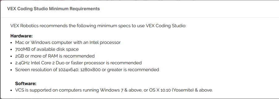

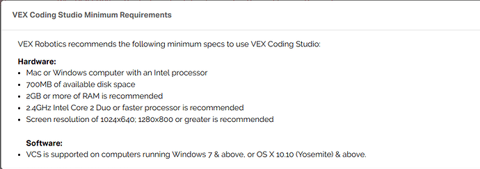

It would seem like you are experiencing a bug with VCS. I have heard rumors at competitions that older devices do not function extremely well with VCS. If you have not allready, I would try emailing the modkit support team at [email protected] and making sure that your computers meet the minimum requirements to run VCS properly (image below).

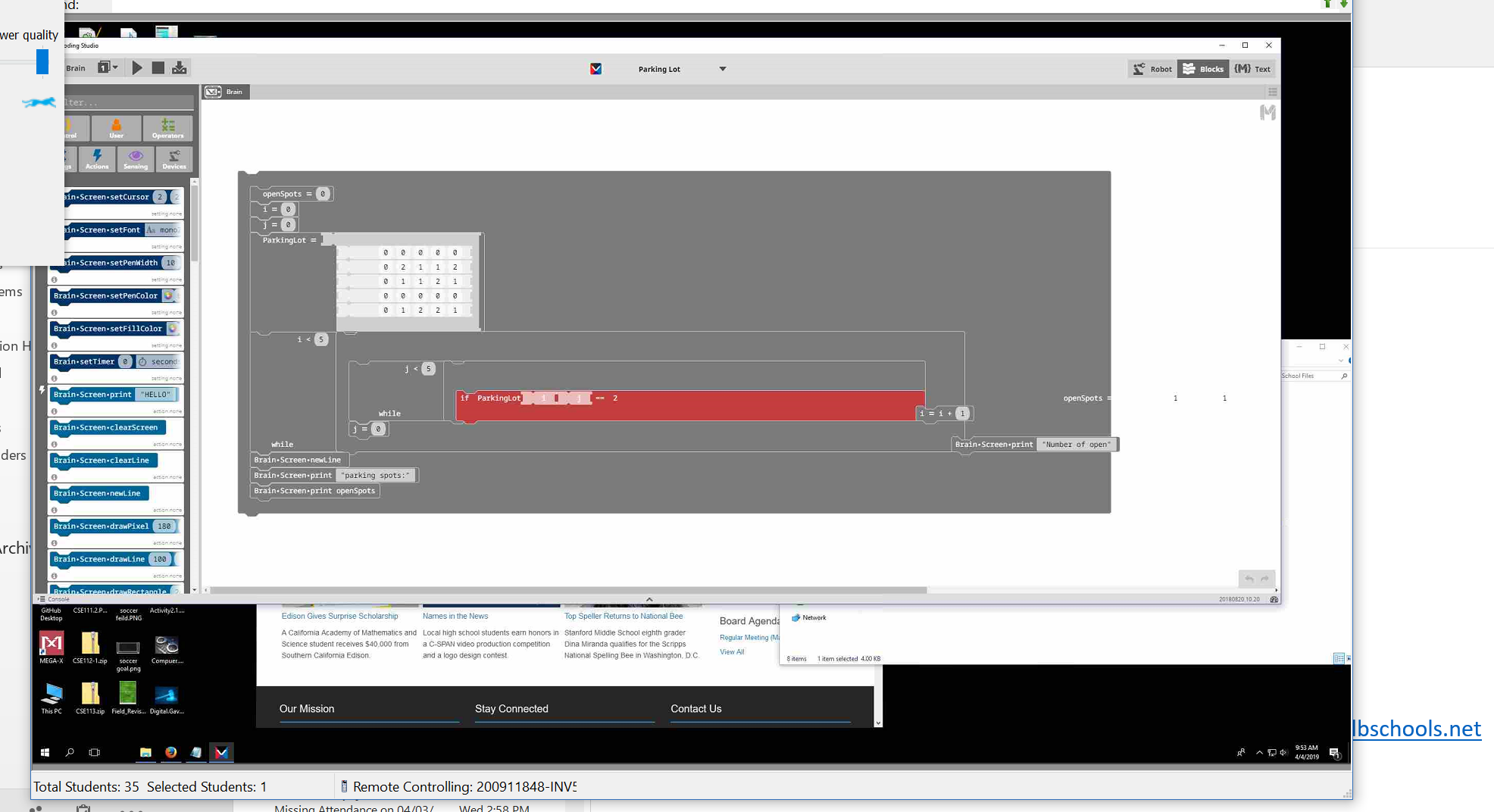

Good Morning - I don’t have my students edit text. They just drag the blocks into the work space and build their programs. They save it and when they return, we get the grey blocks. One block within the grey block is red.

I copied the code from the student computer. It had windows that I couldn’t close or move. This is the code from the CSE course that I am teaching. Line 15 has an extra pair of parentheses, but the student told me that they did not type them there.

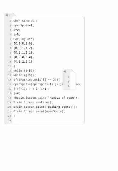

Here is another student’s code from today:
The while loops on line 12 & 13 are not right.
Line 14 has the start of some block pseudocode and it ends on line 19.
