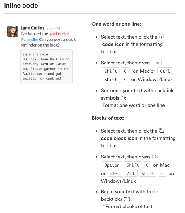

First off, instead of posting a screenshot please copy and paste your code into this forum and then surround it with the code syntax highlighting formatting. This allows people to easily manipulate the code without having to retype it. The syntax highlighting is not a well documented feature but it’s the same as Slack and other platforms (ignore the hotkeys, just use the backtick symbol):
Screen Shot 2020-10-06 at 1.23.27 PM
