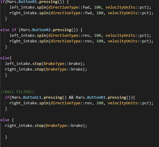

Why does the right intake not run when I hit only R1? It works when I hit both R1 and L1. Does the code not know which one to pick?
