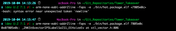

So, unfortunately, I don’t have a brain with me at the moment to do a full stacktrace test, and I still don’t understand quit how to proform the command in a terminal. If you could show me an example that would be great! I was able to run the command that @theol0403 gave the example of.
Unfortunately, I don’t understand how to interpret this error. Thanks for all the help!

The result of your commend gave the location of the segfault to be stl_vector.h. To find out what called the vector error, you need the full stacktrace. However, I can deduce what your problem is - you are accessing an out-of-bounds vector element. To try to change the segfault to a runtime error (which is more informative), do myVector.at(i) instead of myVector[i]. The former has bounds checking and will report what the error is to the terminal.
When you do have the full stack trace, you will have a list of memory locations. You can add them to the end of the addr2line command, or you can completely omit any address to the command and after you run the command you can enter the addresses one by one.
