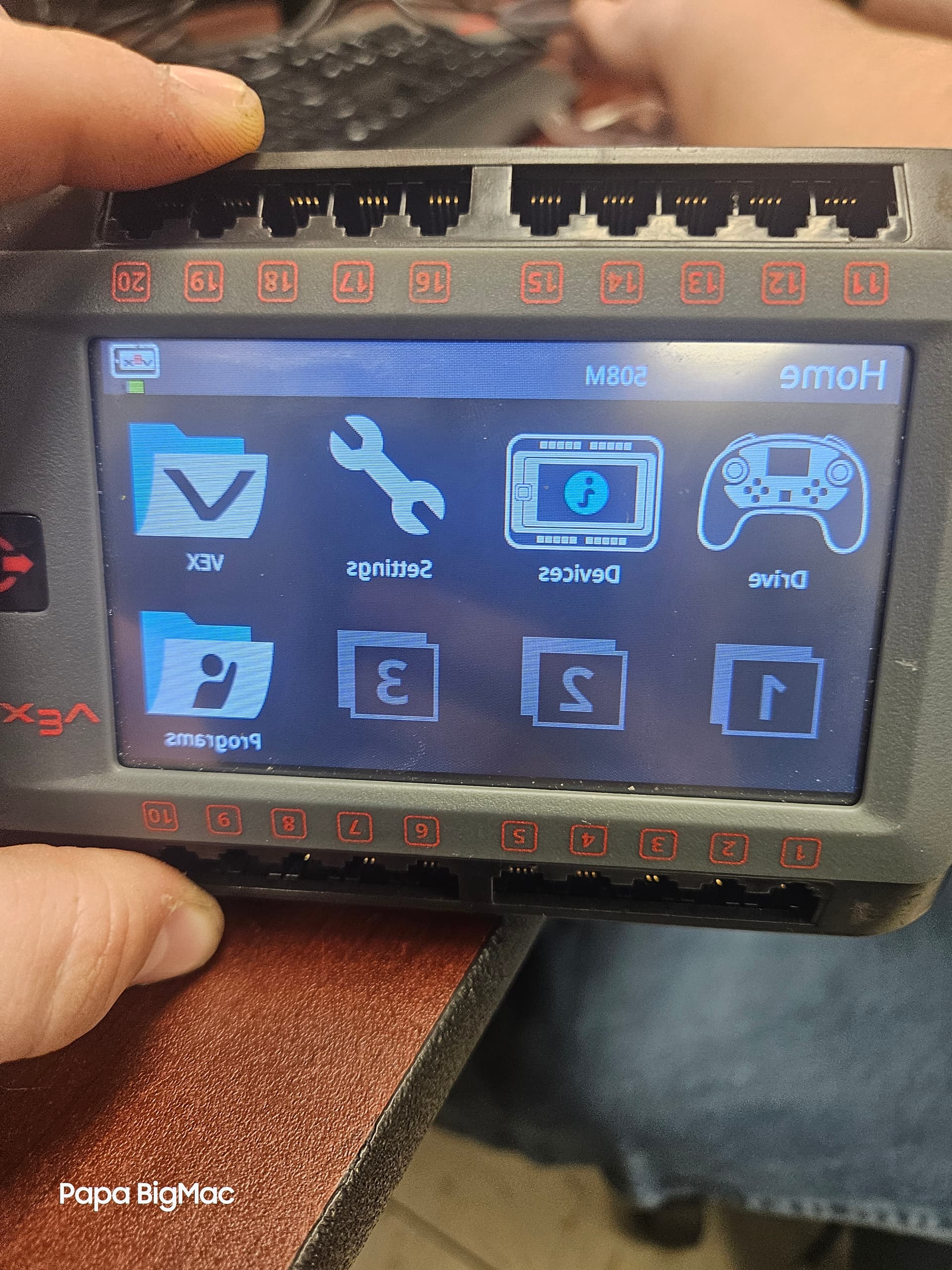

Not sure what happened we were deivijg at a match and the brain go black. then we get this mirrored issue.
we tried to reset all settings on the brain and update the firmware but with no luck

seriously, never seen that before, what happens if you rotate in the settings screen ?
same thing but inverted
Hello I am also a member of the team. I will rotate vertically but still be in the weird mirror mode.

It’s most likely a hardware fault, I don’t think we have any way to that in firmware. I doubt vex support would have ever seen this before. How old is the V5 brain ?
anytime between the v5 release to last year
was most likely 1½ years ago
I’m curious what you get back if you try to take a screen capture of this brain’s video output (you can do this using the VEXcode extension or pros-cli). If that’s unmirrored, then it almost certainly means the display controller hardware or cable has gone faulty.

i tried and it came out perfectly normal
