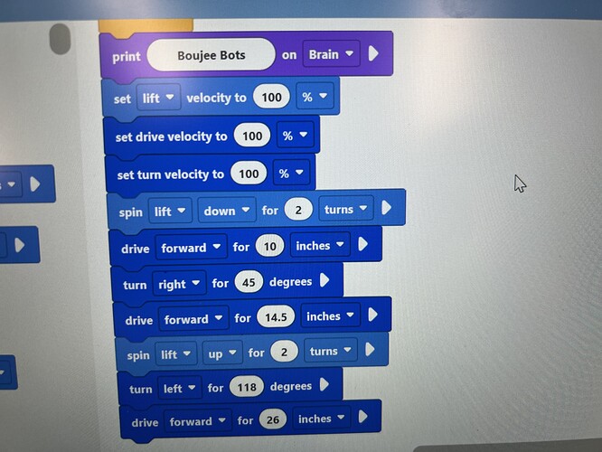

We recently were in a competition and my students autonomous programs worked perfectly and calibrated maybe 3 seconds before moving. When it came down to the 1st match, their brain calibrated for nearly 30 seconds before moving. Does anyone know what may have caused this and how we can prevent this from happening again? Thank you!

As always with code questions, seeing the code makes it 100% easier to help resolve problems. Can you post the teams code please?

Here is their code.
