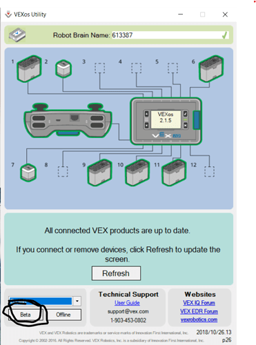

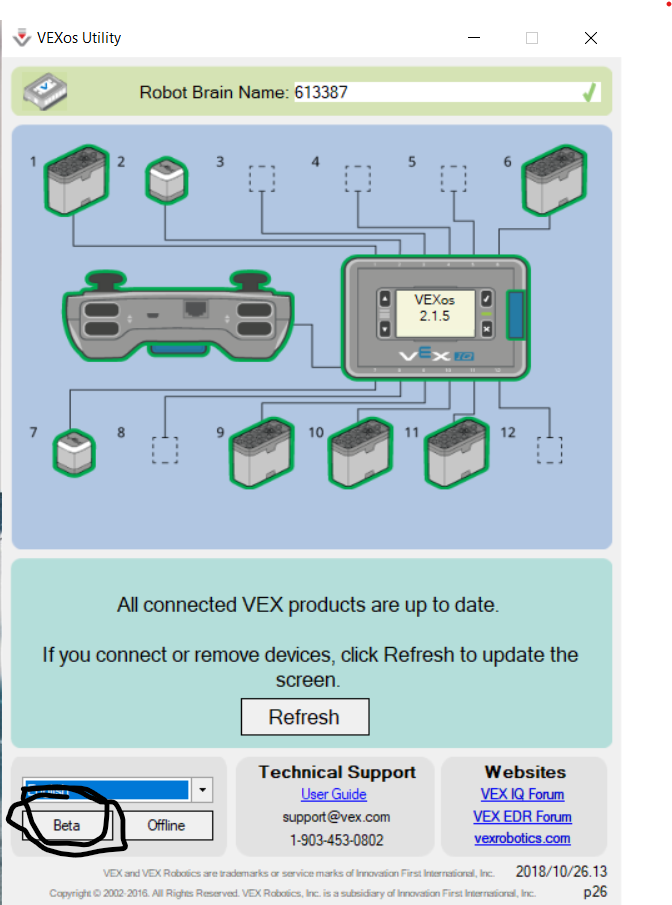

There is another way to do it so first go to the Vex Os app. Then plug in you robot to the computor with the controller connected to the brain and you will see a button on the left side that say Beta click that and it will down load the beta update. That should keep the controller from failing. Here is a image where the beta sign is. It should be circled with the black mark. I am sorry for not uploading the video at my youtube channel, I had difficulty’s.
Er, there is no current beta update. 2.1.5 is the most recent firmware for the brain.
The firmware is unlikely to have any impact on controller connectivity, the most common problem (assuming brain and controller have been paired with the tether cable) is radios not installed into either the brain and/or controller correctly ie. not fully seated on the connector or something has been internally damaged.
