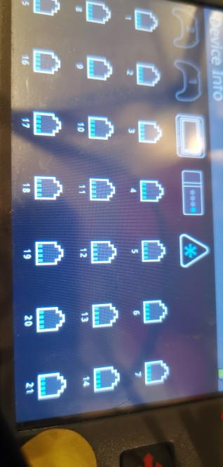

I updated my brain to VexOS 1.0.12, and then stopped being able to connect to my controller or any motor. Even after power cycling and plugging controller directly to brain with v5 wire, brain doesn’t connect to any outside devices. The LCD still works, and when I go to devices on the brain it shows this:
which is not something I’ve ever seen before on my brain. I asked the software channel in the unofficial vex discord, and they said to message @jpearman . Hope theres a solution to this, I have a tournament this saturday
Did you run the skills app ? (well I know you did, all ports have been disabled)
use the “reset all settings…” on the settings screen.
