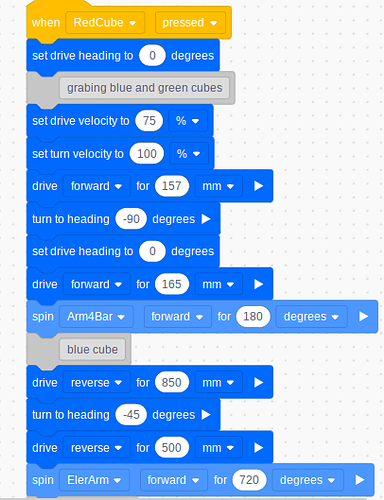

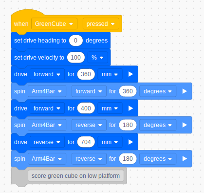

In her autonomous she uses a When Started hat to set several touch sensors to colors, sets motor brakes to hold., etc She then uses 3 When hats to execute 3 different scoring portions. In one of those the robot just goes forward, lifts the green cube, puts it on the low platform then back away and puts the arm down. This works fine.

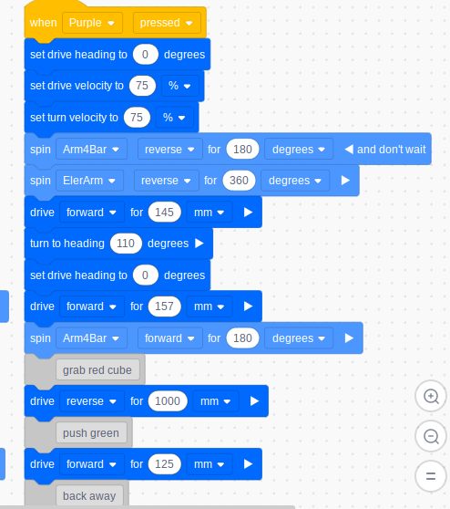

Another When hat is supposed to go forward, make a 90 degree turn to grab the blue cube then back up, make a slight turn and grab the last green cube. This is where the problem starts.
The robot would not turn a full 90 degrees. It would turn about 75. We tried moving the gyro, swapping out the gyro, changing the gyro port and using all 3 of the turn commands and the turn was exactly the same. So I told her, ok, just add some more to the turn so that it ends up at 90 degrees. So she set the turn to 110 degrees but it still stopped in the same place. I them told her to try 360 degrees and still the turn did not change. She then deleted all the programs from the brain and loaded her code again, with the turn still set to 360. It still only turned 75 degrees.

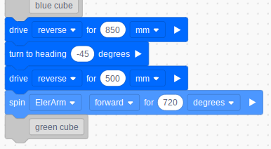

Each time it will execute the next part of the code, reversing towards the green cube, making a turn and lifting the elevator but changes to any of those commands do not seem to actually be getting used either.

Attach the project, only way to know what’s going on.
image image image image
Ok, well what I really wanted to do was download and run it in case it wasn’t actually compiling and just downloading an old copy, bit hard with a screen shot.

There are 3 TouchLEDs. From what you said and what you posted, she may be changing the “purple” led, but running the “RedCub” LED which is blue.

Thanks for the suggestions. I appreciate them, but after her initial frustration, I was observing what went on and looked at the code. She was making changes in the Purple group and pushing the purple button. I made her turn the robot off and back on and check it again several times for each different change she made. This same problem of changes not being taken is occurring in both the purple and red sections because she made changes there, too, and they didn’t take.
In now thinking about it, she did not touch the green section, because it was working, but perhaps she should have made a small change there to help diagnose. Something else I didn’t think of until we got home was trying to put the same program in a different slot
It sounds like what jpearman has said… it’s somehow downloading an old version over and over, EXCEPT, that one time she changed the color being sent to one of the touch sensors, THAT did take. The difference being that’s in the When Started hat, not the When hats. That, too me seems even more confusing.

@jpearman here is the file. Auto2.0.iqblocks (17.9 KB)
Thank you for your patience and help
Does 18K seem right or did she send me the wrong thing?
Well, I don’t see any issues. I tried building on both Mac and Chromebook and the program downloads and runs as expected. I would perhaps suggest adding a while forever loop under the when started hat and print some useful info like drive heading, she could also add some print statements during the run so you know where the code has got to, that’s always helpful for debugging.
