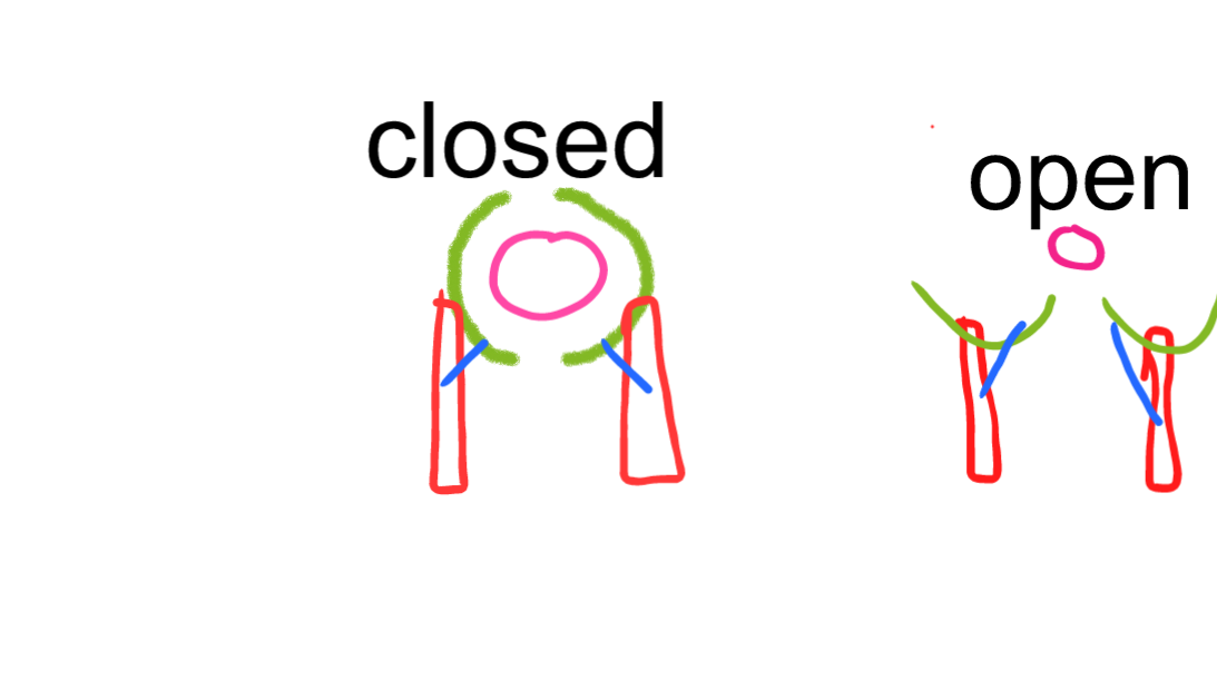

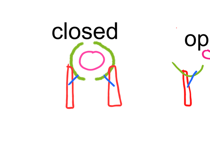

@Joseph W(182 C) i was thinking something more along the lines of a claw, with the fulcrum at the center, wraps around in the ~1" lip type thing, so that when you open it, it gets spit out from the force of it opening, let me draw a sketch real quick
Edit:not an artist so sorry :confused:
green=claw part
pink= mobile goals
red= support structure
blue=pneumatic pistons
I’m thinking of something like what I attached below in sketch. The “claw” is low enough to reach under the edges of the mobile goals and when the pistons start receiving air, the claw closes into the second position. Hopefully, it’ll get the height needed to pass over the 2.38" bar and drop the mobile goal to the 20 pt zone.

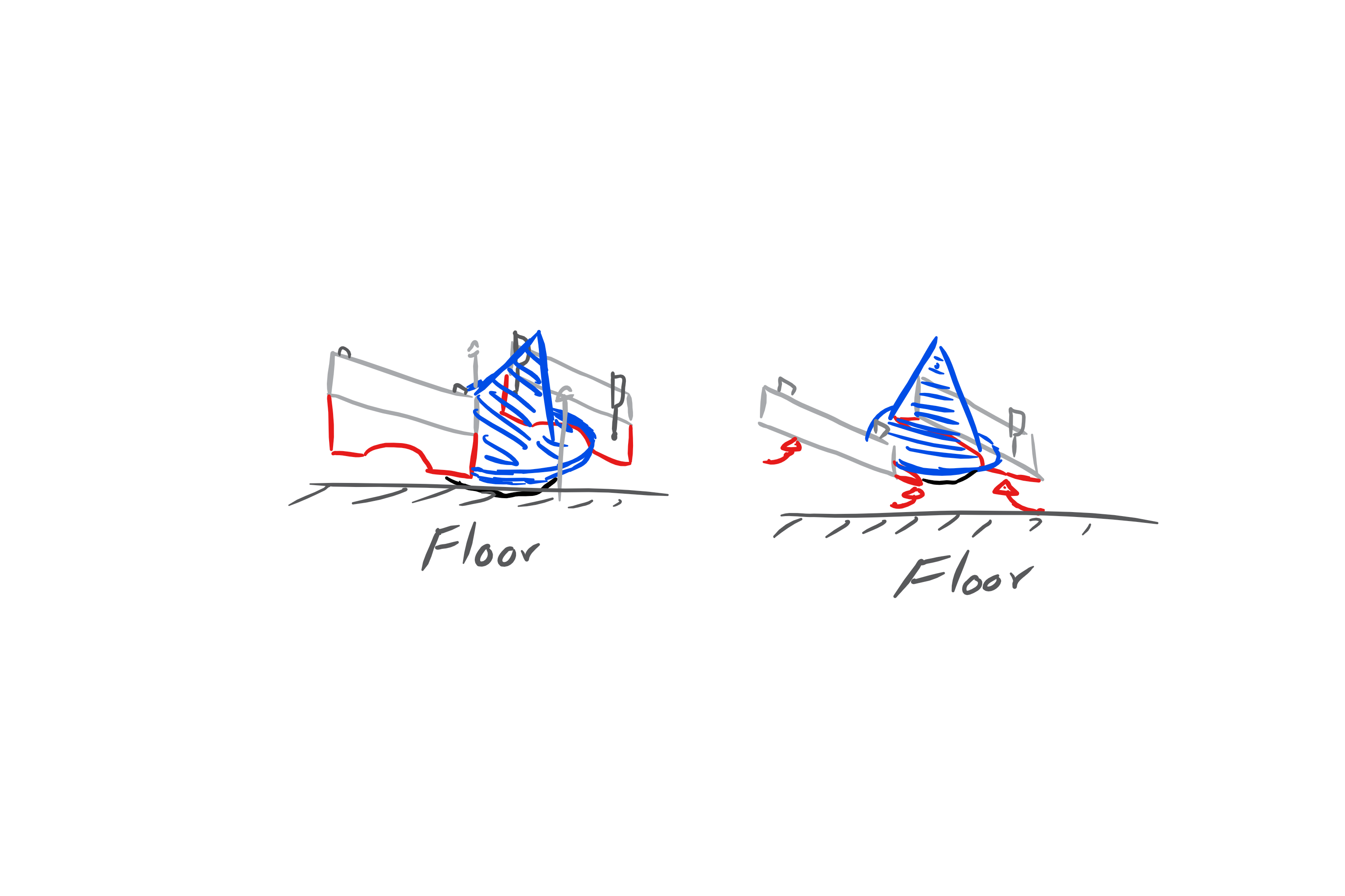

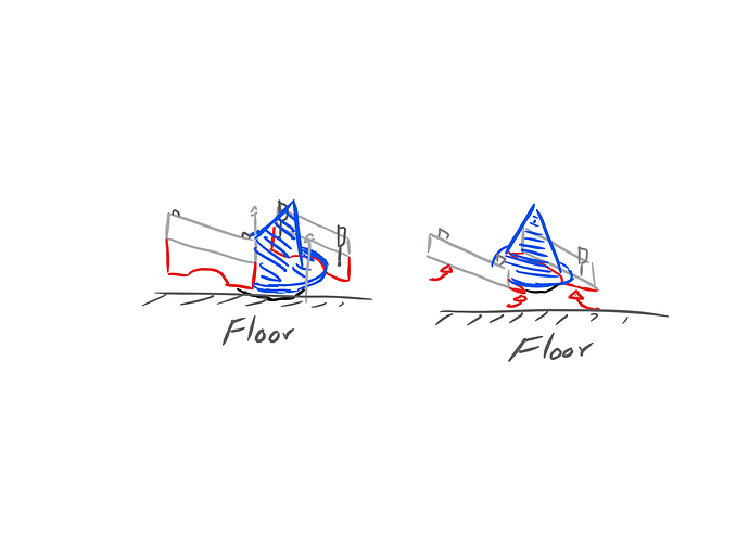

As for your sketch earlier, do you have a plan to get the base off the ground? I’m personally probably going to stick to my original design as it allows the base to get off the ground; unless there’s a simple way to get your claw design off the ground??? B/c i REALLY like the idea of forcing the base out like that and the extra control it gives. :slight_smile:
As many have said, same exact idea. As long as you can get the ground clearance it shouldn’t be a problem. I wouldn’t doubt we have the same idea for stacking the cones either.
@Joseph W(182 C) i already have motors allocated to doing a 1:5 like amll 4 bar just to lift off the ground, also, i think you misunderstood me, im totally doing internal stacker

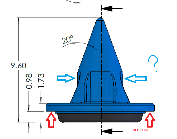

@Yerayrobotics The base can be grabbed up by the upper sides too. I wonder if you have enough room for your fulcrum in the case of grabbing up top versus on the bottom. Look at Fred 4 from long ago.
@Team80_Giraffes Can you help me a bit pinpoint what are the upper sides? I’m not sure if there’s another area where I can get a good grip of the object besides the bottom next to the black part.
EDIT:
Maybe you meant these?
I don’t have extra motors sooo :stuck_out_tongue:
That’s still a really good idea though.
I know your doing an internal stacker, I’m sorry if I worded my post in a wierd way :slight_smile:
Exactly. Where you have the blue arrows. Nestle in there to lift is a possibility versus here you have the magenta arrows below. The cone should not come down to interfere with the blue arrow area.
Ehhh idk about that. Less grip and it has to be in the proper orientation to grab. The bottom will probably be best.
