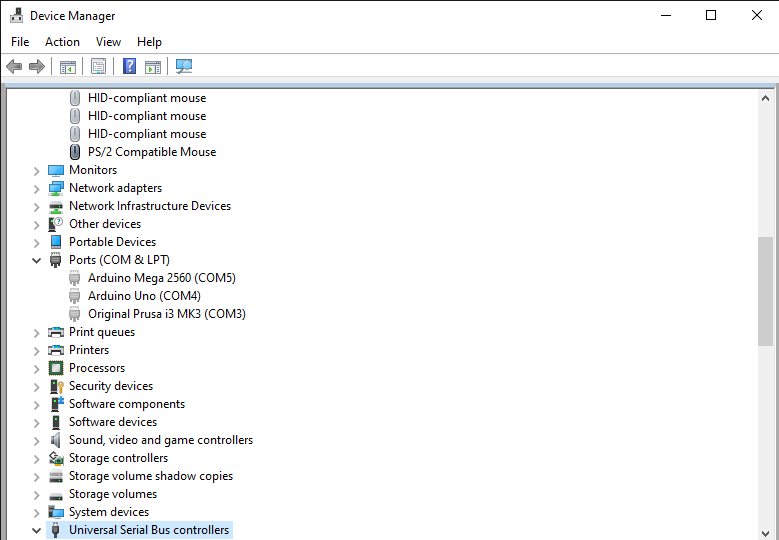

Brand new Vex iq brain will not connect to windows 10 computer
I have tried updating my ports and updated them and went into DFU mode and still will not connect to the Vexos or the Vex iq blocks software. whoever it will connect to ipad and is able to code via bluetooth.
Under device manager ports i saw vex admin COM6 and under other devices i saw 2 vex iq brain. i need to update my hardware so i need help!!!

ok so if you go to device manager and go to the USB section you should see the brain connected if you did it wrong. If you did it right, then there should be no USB section assuming that you don’t have a mouse or something connected. If you did it wrong, then click on the vex iq under USB and there should be a deleted driver section. Then close the device manager and then re-plug the usb cable into the port and turn on the brain. The driver should automatically install. Again, you can always contact VEX technical support.
what is the usb section
under ports there is no device
if you can’t see USB/COM ports in device manager your good
Then just re-plug the usb cable and turn on the brain.

i think the drivers are still download but the device icon is not there
do you have discord were we could share screens
nah sorry bro
20 char
image does this help. it is on and plugged in no other devices are plugged in. i think i deleted the icon thing but no the driver. it doesent even make the plugged in sound.
is there anything under the Universal Serial Bus Controller
If there is nothing turn the brain on and then plug the cable in
such as… a vex iq thing
ok unplug, turn brain on, then plug it in a different usb port.
what am i looking for
