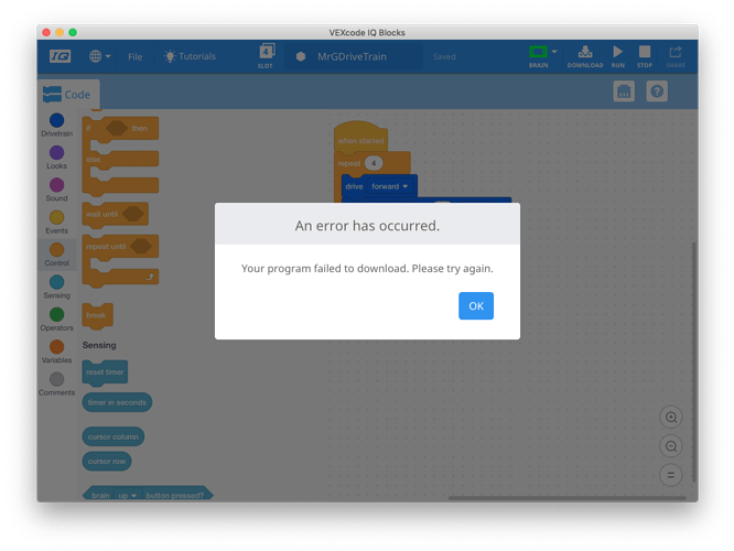

BREAK Block causing Download Failure?
We’ve now been using IQ Blocks for a couple of weeks in class and there was difficulty with programs not Downloading
I have discovered that if there is a ‘Break’ block at the end of the Program, the above error occurs.
Are we doing something wrong? What we are looking for is a ‘final’ block that finishes the Program (so that the Robot is no longer ‘running’ and the display returns to the initial Menu Screen).
(On that note, every time that we download a program, the Menu goes in to Settings (rather than stay on the initial Programs screen) - would this be another bug?)
Thanks :slight_smile:

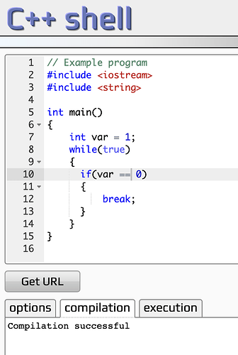

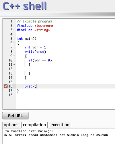

Not really a bug, but more of a compiler error.
“break” commands are used to escape out of repeating conditional or loops. For example, you could use a “break” command to end a “forever” loop. “break” does not do anything related to controlling motors or terminating the project.
Using a “break” outside of a looping structure will generate a compiler error.
Good:
good_break
Bad:
bad_break
