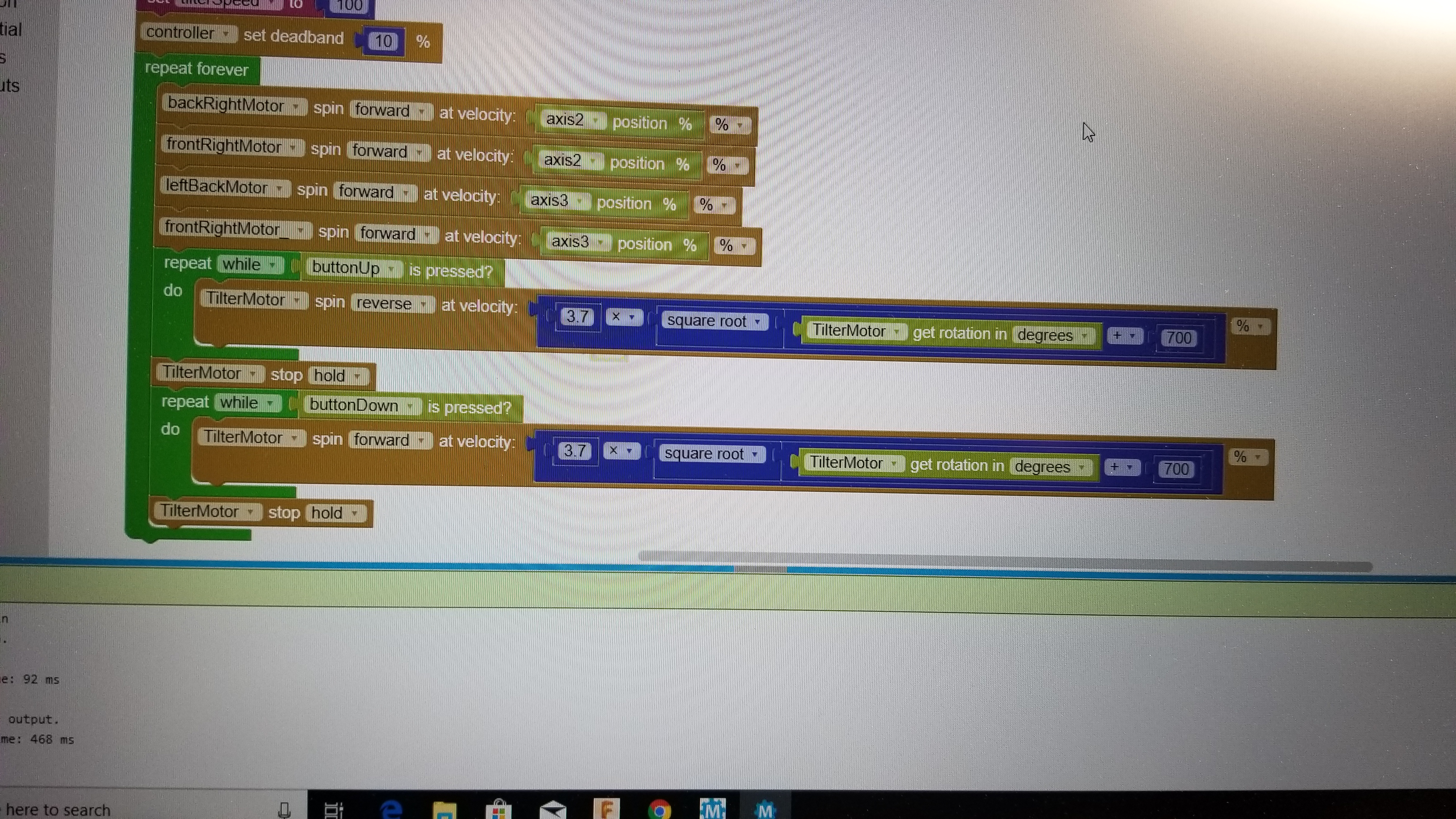

When I run this program, the brain automatically exits out of the program when. I raise the tray. My hypothesis is that eventually, the brain is trying to move the motor at i percent speed, and it just nopes out of there

Accidentally calculating i should throw a value error, not crash the interpreter, as seen below:
Could you please give us a link to your project?

Also, this is just what I suspect, there may be another issue I didnt notice. The code has since been updated to not make the program exit.

It’s possible you’re hitting a race condition between checking the condition of the if and setting the tilter motor to move. Try storing the potentially unsafe value (tilter motor encoder + 700) in a variable. That way you can check against the value of the variable and have a guarantee that it will be the same value you later do math with.
