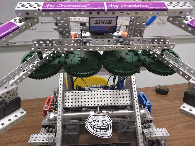

Wait, are you holding a clawbot while displaying your Troll sticker?
It takes some time to get one on, but yes it can carry clawbots muhahaha

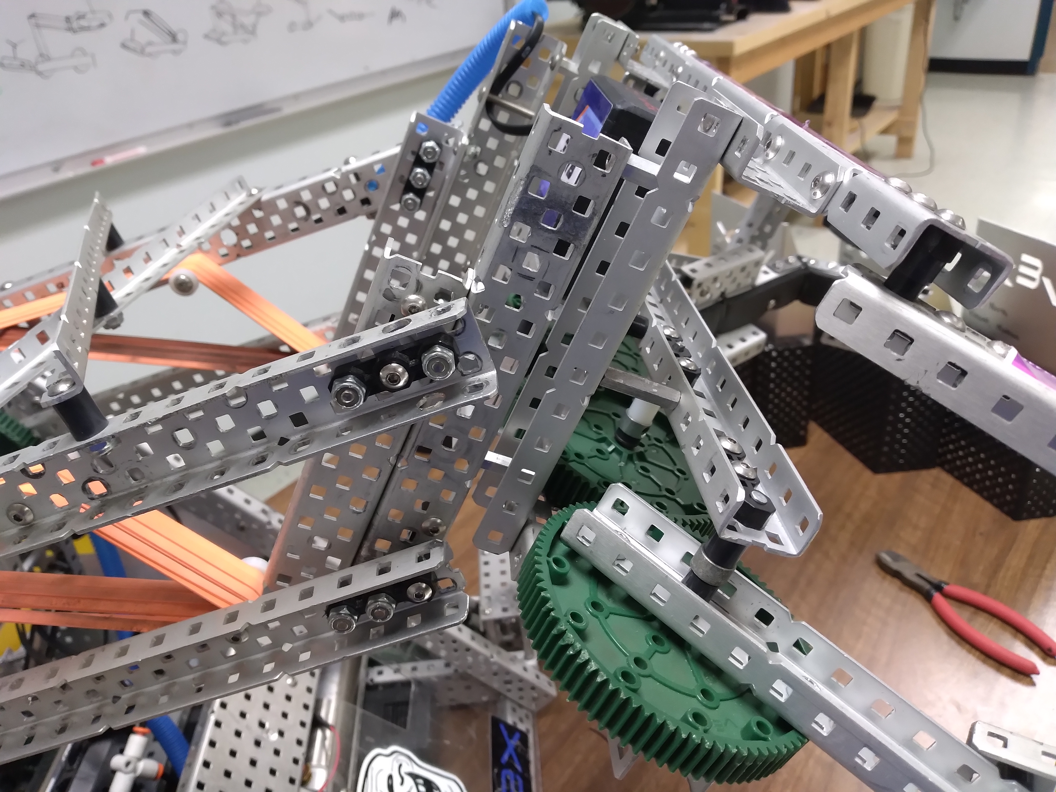

Hey, I was wondering if you guys may be willing to release a rundown of how you made Brevity’s claw. My group found your robot and would love to make it in our school’s robotics class!
The build is very similar to that of a dr4b in that it is mostly just c-channel screwed to gears so that they move in opposite directions. The hardest part was getting it in size, there are probably multiple ways to do this, we thought it would be best to be able to close the claw so it is easier to mount, the shot 42 seconds in demonstrates this, but there are other ways of doing it that you could find using the design process.

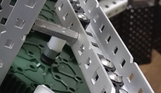

Here are some close-ups:
You basically connect four gears and mount the claw on the outside ones. The rest of the frame is just reinforcement.
Do the axles on the edges have their edges hammered down?
Yes, but when we found the axles they were already like that.

So how hard was it to make it lift with only 1 motor? Also how do you have the actual claw part bent differently than the c channels connected to the gears?
I highly suggest only having one bearing per screw joint and just screwing in the screw onto one side and have the bearing flat pivot around the joint. This will have less slop and friction overall.
Also where you connect the standoff to the claw I would suggest a 1.5” screw and run it through the entire width of the C-Channel with spacers and screw lock.
It may also be a good idea to use a screw joint as much as possible for your claw as axles are known to boe under load, causing the gears to grind out of place. Additionally the triangle banding would have drastically less friction if you allowed it to roll around and stretch. You can do it with a screw joint, spacers, and a nylock at the end.
It wasn’t that hard to make the lift with only one motor, but there are a couple thing to look out for like making sure the two sides lift evenly even with just one motor.
