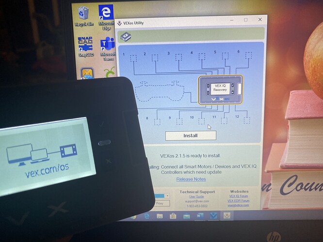

First year team here. We have somehow managed to brick 3 brains in a week. Luckily we’ve overnighted new ones. Our robots have worked great up until the new update. I’m not sure what keeps happening. I have pressed up and down and check to put it in recovery mode and it is recognized by VexOS, but as soon as I begin to install the brain goes to the VEX screen and VexOS says to hit the check mark to turn the brain on…

Are the Brains not actually switched off when it says to hit the check then? It’s normal for them to reboot in an update but they need to be turned on again manually during the process.
@calvc01 right, it’s not actually turned off. When it initially turns on it goes to this screen…
image|666x500
It starts to download then goes to the last screen and now it doesn’t read that anything is there.
looks like you may also have VEXcode blocks open, make sure all other programs that may communicate with the brain are closed.

Is the brain showing the “vex” screen then shutting off?
@UnknownAsteroid it’s showing the VEX screen but it just freezes on that screen. I have to take the battery out to get it turned off

@Foster I just tried that and it didn’t work. It is so frustrating. It is just stuck at the VEX screen. When I shut down Vexos but left the brain on When I restarted it it doesn’t registered that there’s a powered on brain connected.
