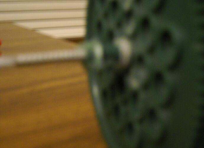

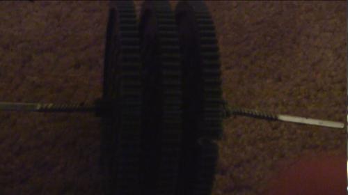

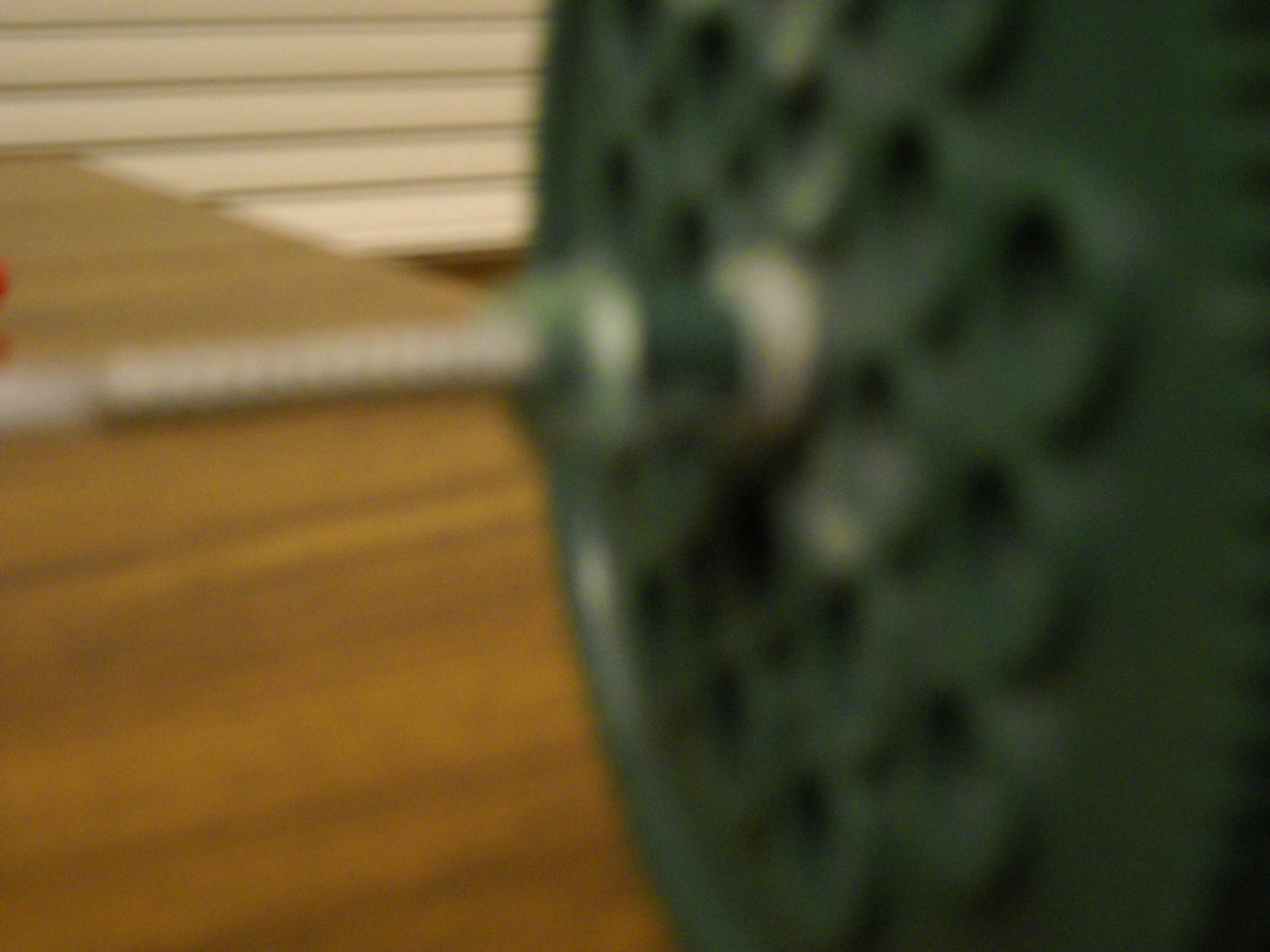

Do any of you know how to get the gears off because frankly, I really want to be able to keep this axle sorry the picture is so bad.
What exactly is wrong with it?
I’ll get a better picture up in a little bit but the thing is the axle twisted if you can see on the sides of the gears.
WOW…dude, I don’t see any way you’ll get that axle off clean…Unless you dremell (cut) all the way around the sides of the gears…Did you just want to keep the axle as a trophy? Thats what we did last year. Heck, if you do something that terrible, might as well keep it, right?

I think when we did that we used a pair of pliers and pulled it off as we were twisting it. It will require some strength but we managed to save the axel.

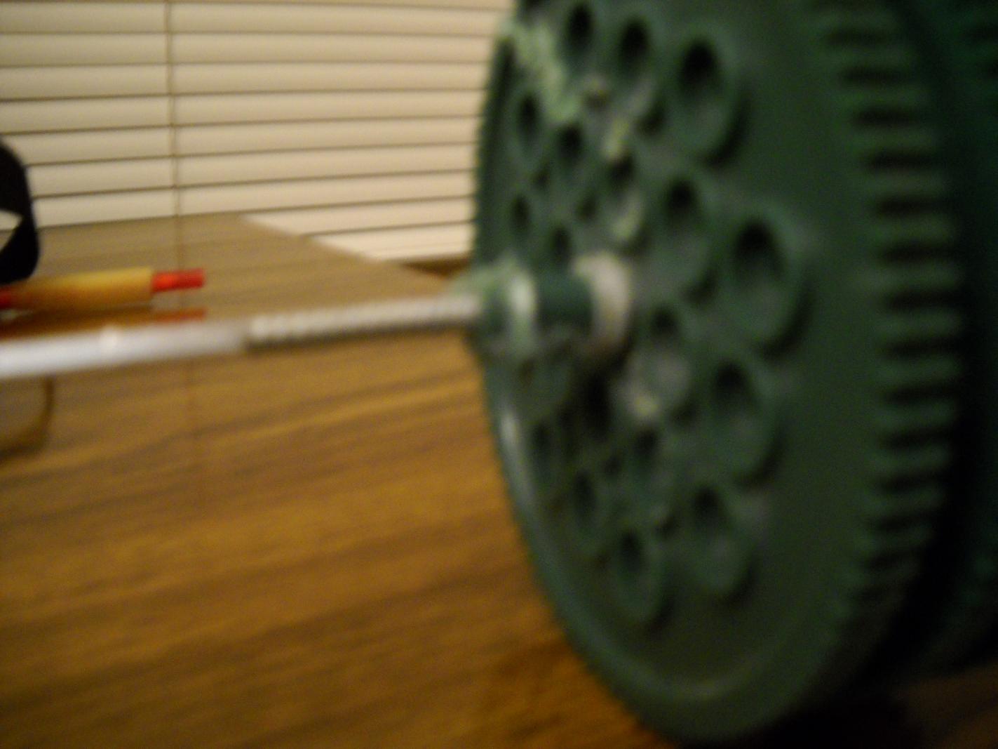

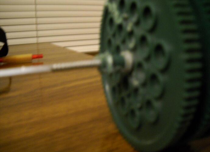

Here’s some more pictures if you guys can think of anything I just want the axle as a trophy.

Now that’s a lot of torque. What was your gearing?
If the gears are shot, I might try beating it with a hammer until the gears break the rest of the way off. If you want a more civil solution, then the dremel suggestion should work fine. With an axle that twisted, I think it would be difficult to just pull the gears off.
It was the smallest gear to the largest gear with a 393 on each side
The way I look at it, either the Axle or the Gears need to be cut.
Option 1: Use a saw or dremmel to cut the axle as close as possible to the gear.
Option 2: Cut the gears off. Based on how much that axle is twisted, I find it hard to believe that the square holes in the gear are in good condition.
Why not just leave it as it is? Too bulky maybe?
Its not likely you’ll be able to salvage the gears anyway, unless you used locking bars.
We had a similar thing happen to us last year (not close to that extreme). We found that it was caused by having too much force being put on the axle, so if you are going to replace it, either reduce the amount of force that that axle is going under (eg. make mechanism lighter if that axle is lifting it).
If you are really wanting it to be the same, add more gears to spread out the force on the axles. It really helps a lot.
