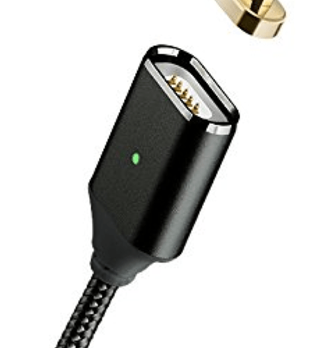

Our team was weary of the MicroUSB ports wearing out on our brains from when we got them, (I had seen it happen first hand on the VexIQ brains) so we ordered this after it was recommended from one of our members:
Magnetic MicroUSB Cable
I have to say this was a very good investment. Especially since wireless programming has not been implemented, we can quickly connect to download programs over and over without worrying about the port getting damaged.
Is there any worry about static build-up going directly to the microusb port with that piece attached?
Haven’t had any issues yet, been using it for about a month. If there ever is I’ll update below.
