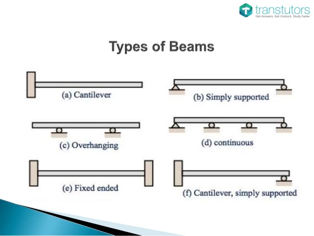

Based off of what I know cantilevering is where an object is supported by only on side, anchoring something isn’t called a cantilever.
My bad. I meant a braced cantilever where the towers are the cantilever, and the standoffs are what braces the towers to the drive.
Its all good.
Make sure something that isn’t supposed to move, doesn’t move, and something that is supposed to move, moves with little friction
For Reference
