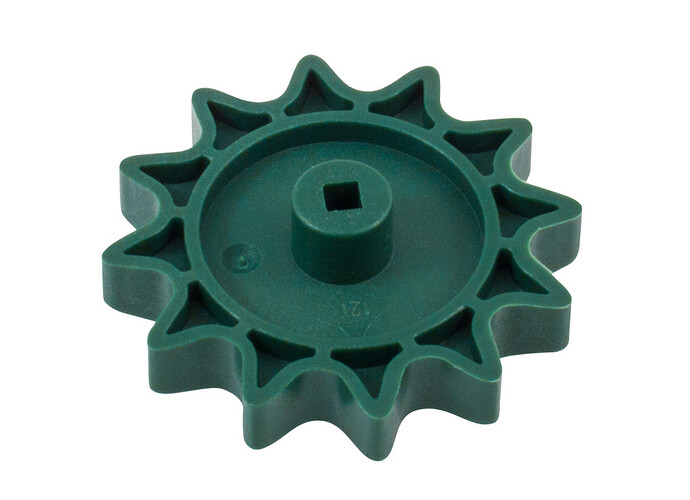

So I’m in the beginning of designing my robot for our next competition. I need some help on our drive side. I have dedicated 4 motors to the drive but not to sure if they would be to weak. I was going to directly put the axles and the wheels. Would it better to put gears or chains or would it just create to much friction?

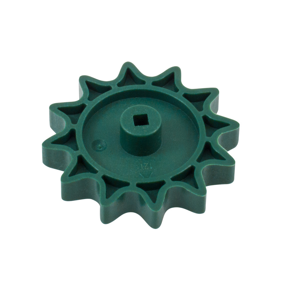

Would this one be good are is it to small
I think those ones are fine, I believe the ones @Team80_Giraffes is referring to are the 6 tooth sprockets.
