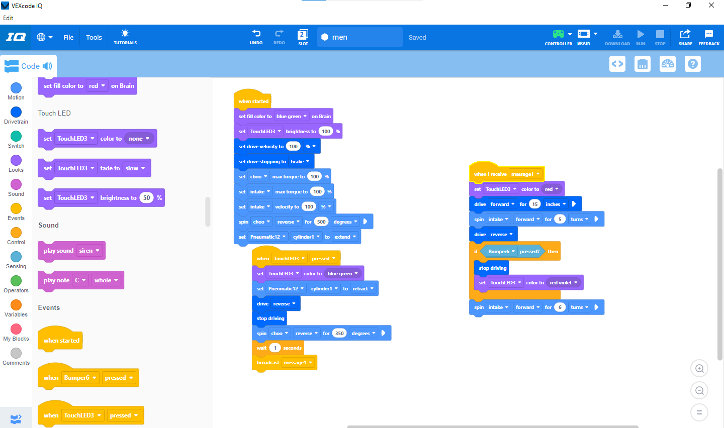

We have a code and we want when bumper pressed to do different things however when the bumper is being pressed it runs the first line again. I was thinking we could have a code that said when bumper pressed increase value by one then instead of it being when bumper pressed it would be when value is this number however I am not fully aware of how to do this yet. If you could help me do this or find some other solution it would be appreciated.

You should explain what you are hoping will happen with the code and what actually happens, otherwise any advise is just a guess.

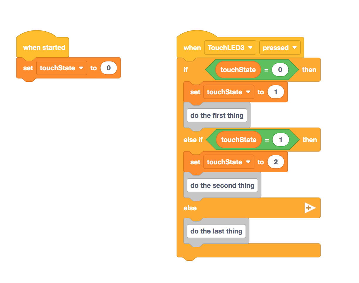

I want the first time the bumper is pressed to launch the catapult then pull it back down however the second time the bumper is pressed I would like the back roller to spin. However currently when the bumper is pressed it does both at once How do I fix this?

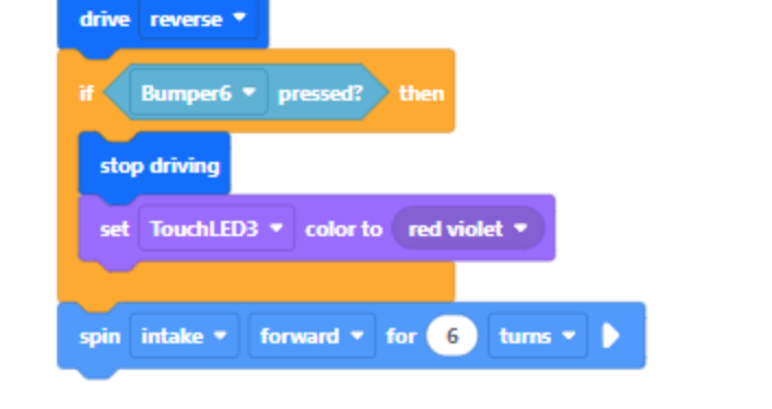

terminology is important, the only bumper sensor I see is here, is this what you are talking about ?
or are you really asking about a touchLED ?

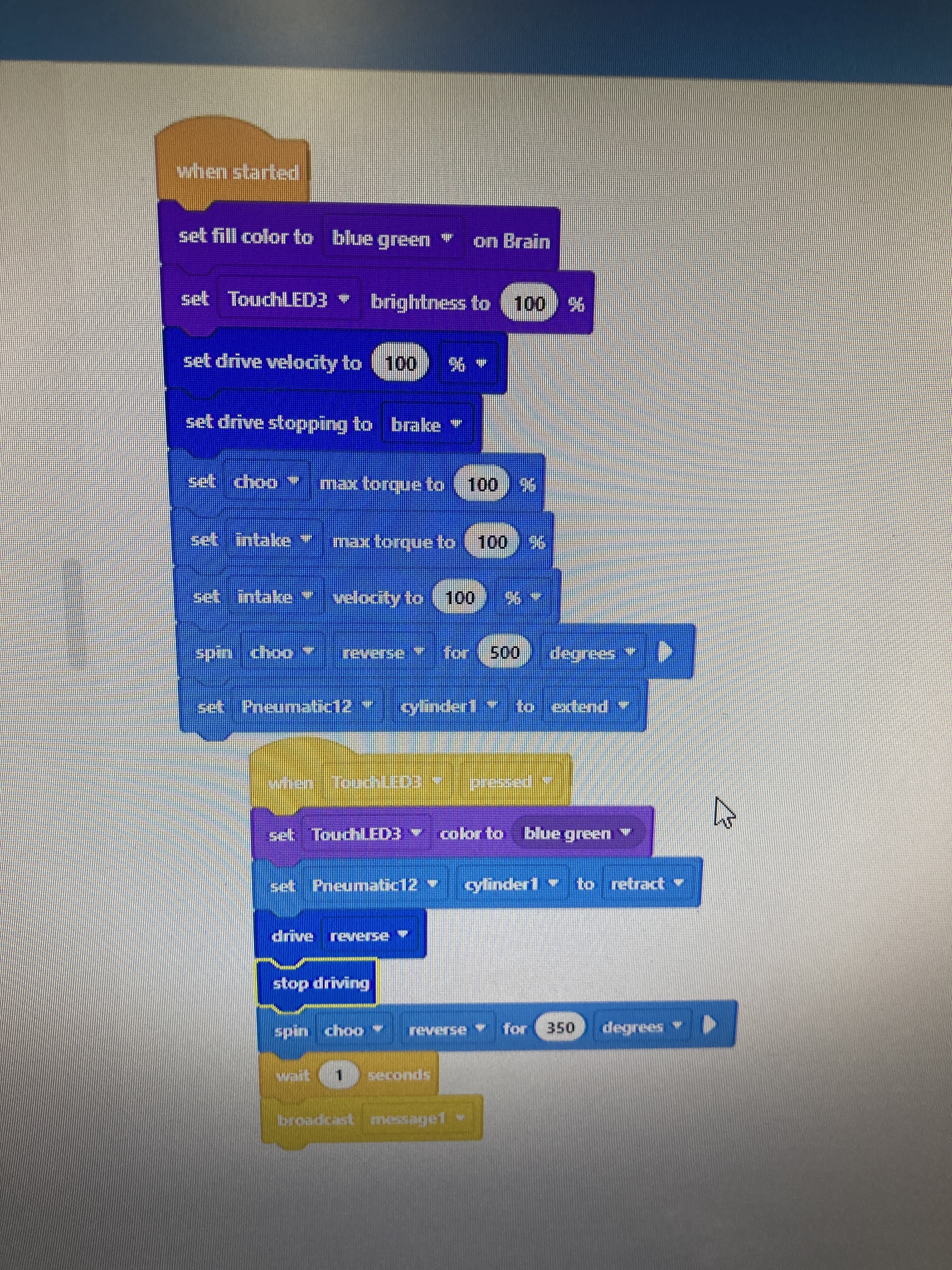

there’s a lot of code here that makes no sense at all.
I guess you want something like this.
Sorry this is what I meant to upload partner changed code without me realizing I did mean bumper
Yes kind of but we need when bumper pressed increase touchstate by 1

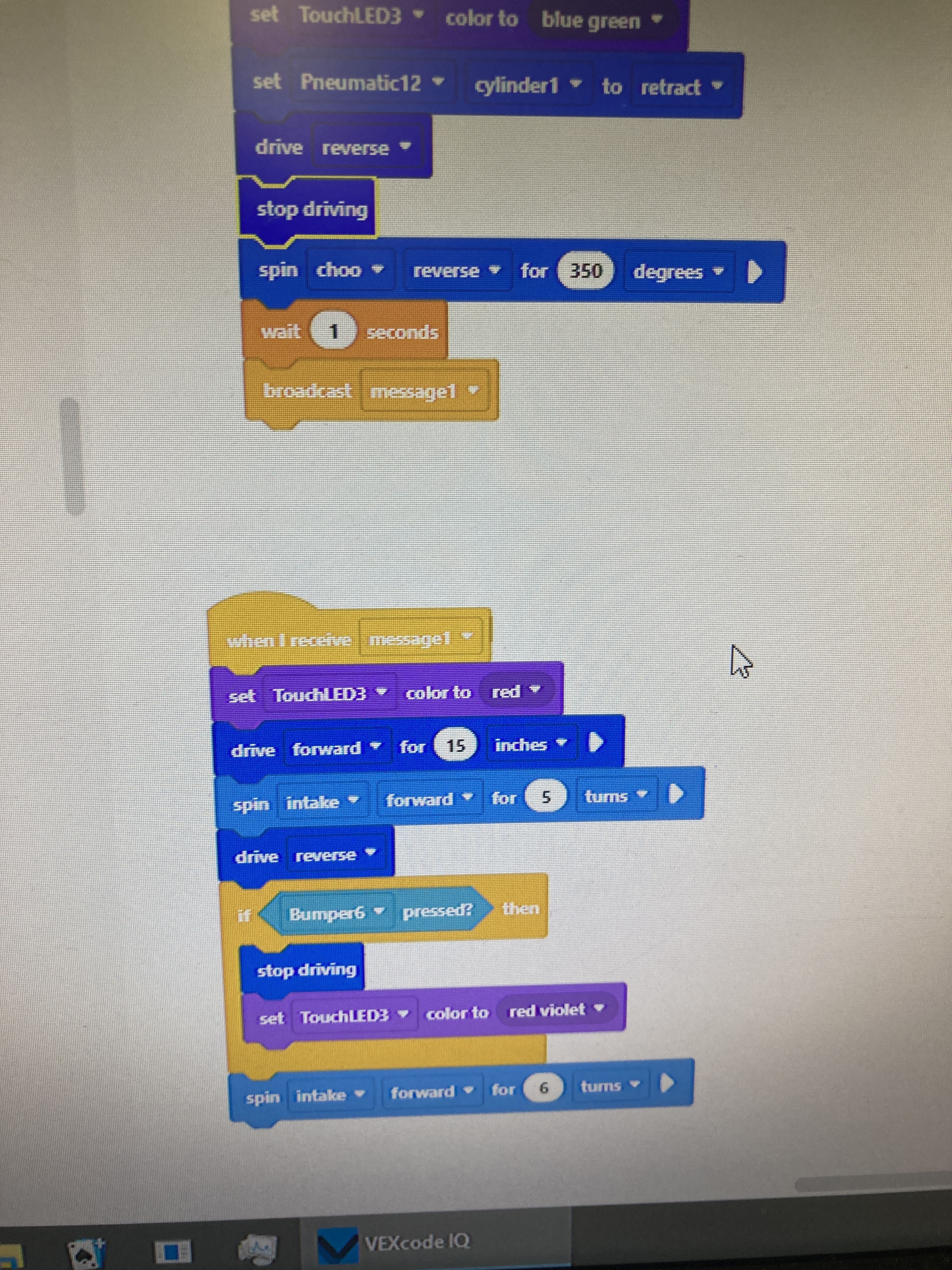

The broadcast is messing up your code
