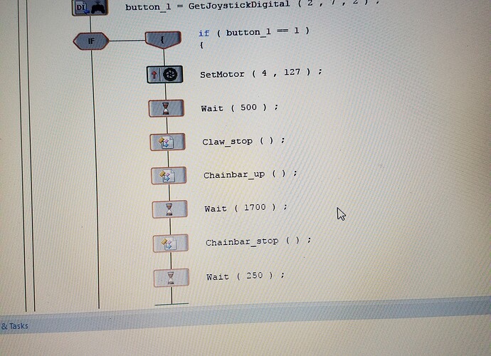

So this year we want to be able to click a button o n the controller and it will pick up a cone and drop it on the mobile goal. We are using easy c and we got it done but if we are driving then hit the button it would keep driving until it finished the program. Is there any way to make the driver gain control of what is nit running in the program or not?

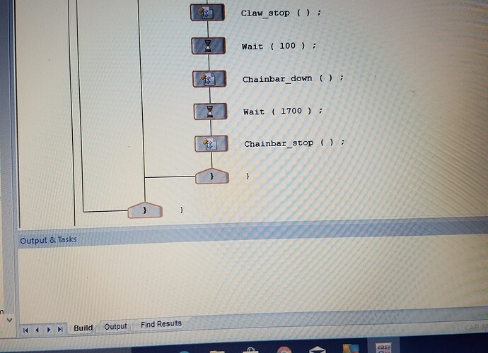

This is my if statement which is inside of a while loop.
Unfortunate easyc is not well suited to what you want to do because it cannot do multiple things at once the way RobotC can (one reason why we switched).
The problem is that you are relying on wait statements in your button code. While it is executing the steps in the button_1 if statement, it is not doing anything else, like checking what the drivetrain joystick is doing. So anything that was going on when you press button 1 will continue until it gets through all of those wait statements.
The only solution I can think of for you is to rely on timers instead of wait statements.

Then the next series of movements will not be in a big if-statement, but will rather check the timer each time through the loop and turn the motors on/off based on what time it is.
This is not a trivial change to your programming to make this work, but I think it is the only way to do this in easyc without a bunch of wait statements, which are pretty much death in a joystick program.
