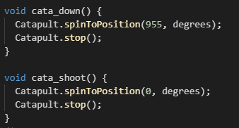

i have coded this so that the catapult will move down to a position before it slips automatically when a button is pressed and another button to shoot it. however it will not run, so what am i doing wrong?

Can I see the functions the callbacks are calling?
Screenshot 2022-10-17 130934
here

Try removing Catapult.stop() - it is redundant, as spinToPosition stops when complete. This would also let you convert the spin to non-blocking by adding false at the end so you can continue driving while the catapult is moving into position.

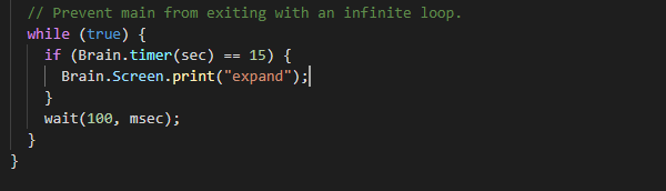

could you provide an example of this, I have never used the brain timer fuction before??
This is inside of a while true loop
    if (Brain.timer(sec) == 15)
       Controller1.rumble(".");
You can also use Brain.timer.reset();
i have tried that, still nothing is happening.
