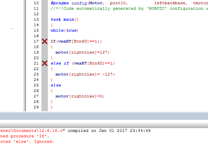

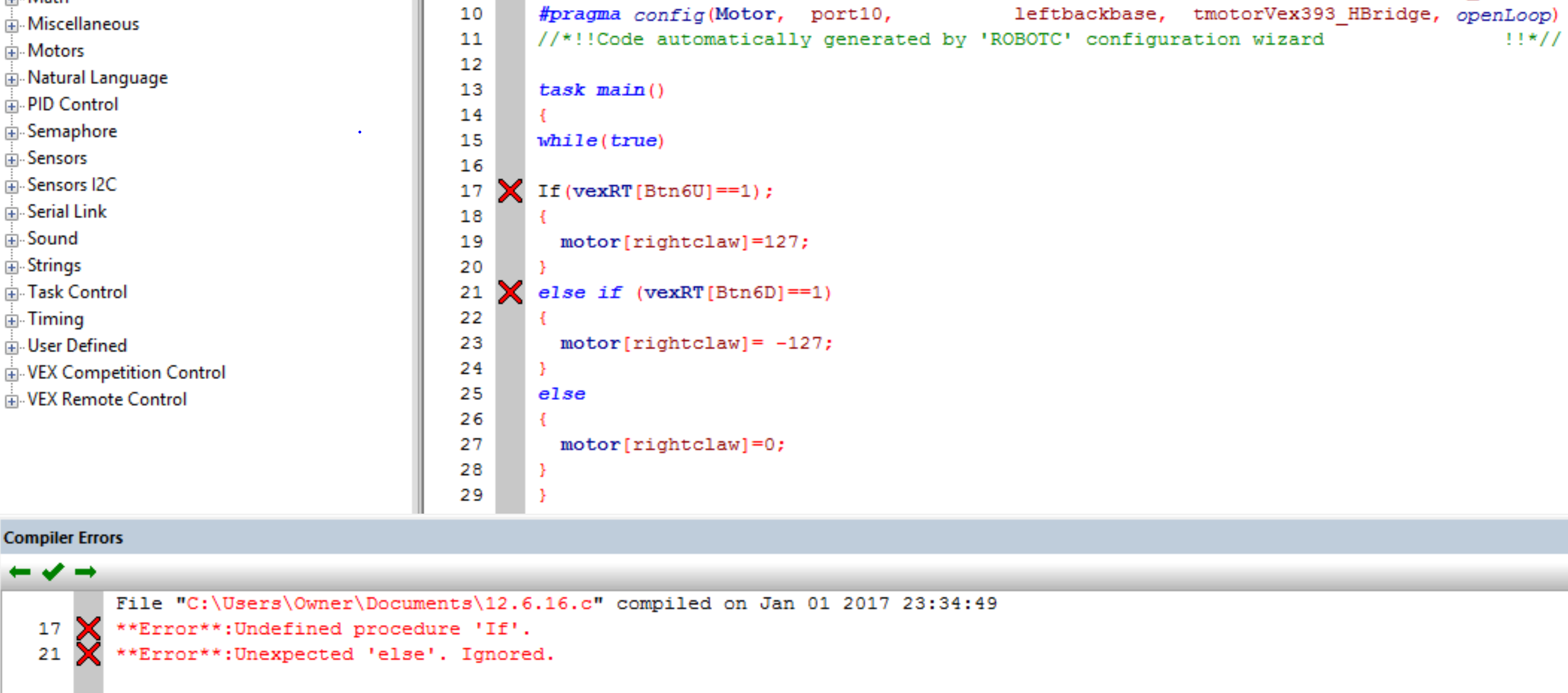

Hello I am trying to program a button to my remote but it will not work any feed back is awesome thank you.
task main()
while(true)
If(vexRT[Btn6U]==1);
motor[rightclaw]=127;
else if (vexRT[Btn6D]==1)
motor[rightclaw]= -127;
else
motor[rightclaw]=0;

This is what it is saying.
The “if” needs to be lowercase…
I don’t know if RobotC is finnicky with these kinds of things, but I think you’re missing curly braces for the while loop.
Missing { } for the while loop. No?
[missed NightsRosario post – agreed with {} ]
You’re missing curly braces for the while loop. This is what your code should look like:

Ok thank you guys for your help.
