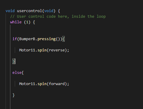

Hi guys I am trying to program a Button Switch but I cannot figure out the code to save my life. I am new to programming and would like some help with some pseudo code to help make it work.image
Hi @Jax1, welcome to the VEX Forum!
Does the code you posted compile? If so, what does it do, and how is that different from the behavior you want?
It complies. When it runs all it does is spin forward. When I push the Bumper its supposed to reverse the motion but it just continues to spin forward.
Is the bumper pushed for a very short period of time or is it held down for a period of time.
I have tried holding it down because of the pressing command that I used in the code.

The only two potential problems I can see with this are either that the bumper switch is on the wrong port or that there is code after the if…else block that is overriding the the spin command

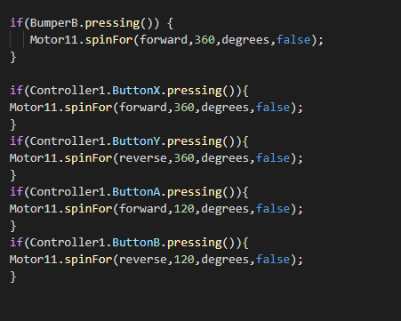

This is all the other code I have
for better reference
The first if in that above code is overriding the if…else at the top of the loop. If you remove the
if(BumperB.pressing()){
  Motor11.spinFor(forward,360,degrees,false);
then the code should work

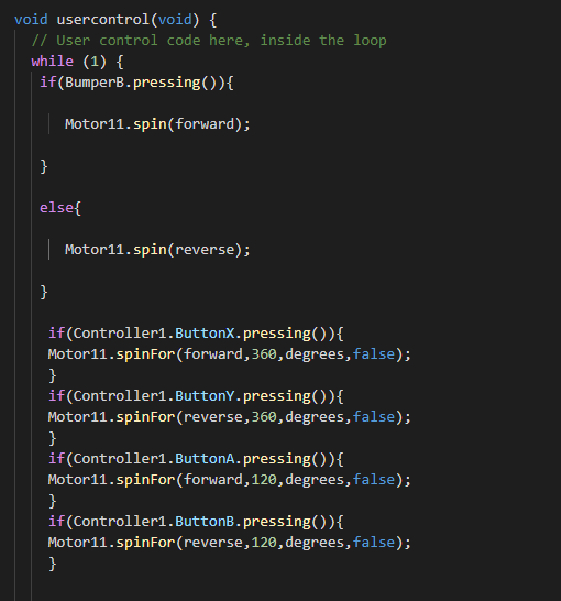

Ill try this and if it works ill be incredibly happy!
It still did not work. This is my code
is it because it is not checking to see if the bumper is pressed or something like that?
You changed the first if statement so that the motor goes reverse by default.
What do you mean? I am confused
You made it to where if the bumper is 0 it spins reverse bcz you put while 1 it spins forward and else when its 0 to spin backwards. And 0 is when its not being pressed so by default it spins backwards
In the original post you had:
[pseudo-code]
if(BumperB pressing) then spin Motor11 reverse
otherwise spin Motor11 forwards
Then you changed it to
if(BumperB pressing) then spin Motor11 forwards
otherwise spin Motor11 reverse
