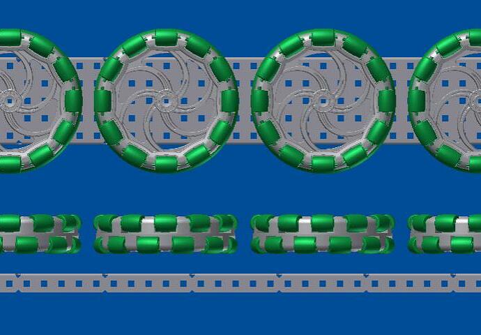

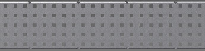

Does anyone have a 1x5x35 C-channel picture. I need the flat face.
I am trying to figure out something, and I don’t have our robot.
Thanks!

See attached.

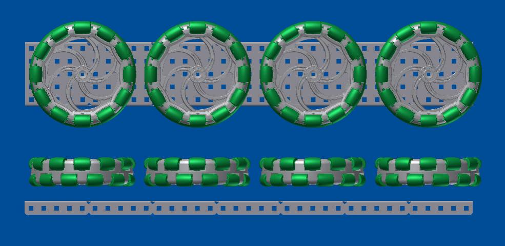

Do you know how many wholes a 4 in omni takes up?
Could you stick an omni behind the c-channel. Can you stick 3 omnis behind it, at the right side. Try to squize them all into the right side. I would like some space toward the front.
Trying to get measurements.

Every hole is .5" apart so if you put a 4" wheel 5 holes in from the outside then it would be about .25ish away from the end of the metal. This would be the furthest you could push your wheels out (relative to the front/back) in a drivetrain without exceeding 17.5"
Edit: You could place a 4" wheel every 10 holes and have .5" between every wheel which would fit 3 wheels into a 14" long C channel.
I got what I needed, thanks yall!
