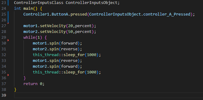

Hi, I’m quite new to vex but have a little bit of experience with C++. I am trying to move my call-back functions for the controller inputs into their own class and C++ file so that I can clean up my main file. However, when I do so I am left stumped as to how to pass the Brain object (is it an object?) to the brain.Screen.printAt() function?

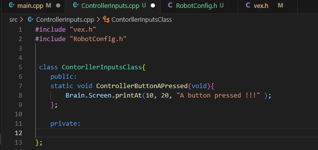

My class looks like this :
My creation for the object of the class and main loop looks like this :
screen shot 2 vex v5
Any help would be greatly appreciated and thank you for your time :slight_smile:

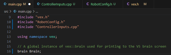

Brain is a global object of type vex::brain. In a typical VexCode project, it is declared in robot-config.h and instantiated (defined) as a global in the generated robot-config.cpp
You could thus use it anywhere, as long as you #include <robot-config.h>
Like this?
Separate header file but ik I could put it in vex.h
Initializing it in the main.cpp
Using it in my second file
I think I have come up with a solution however I am unable to test with an actual robot rn so will update whether it works or not but it compiles without errors :slightly_smiling_face:
I create an object from a class that is located in the second file above my main loop and then I call a function from the class from the callback. with ClassName.MemberFunctionName (I also #include “SecondFileName” at the top)
My class in a separate file
I have also added another header file so that Brain can be assessed from both .cpp files as mentioned in my other reply on this thread. (this header is also #included at the top of both .cpp files)
If you run into issues I also had to define my function as static as depicted in the second image as the callback functions must be static. I’m not sure why but I had to.

Yes, having static functions is a “solution”. I use quotes, since with that solution, you loose the context (a.k.a. this) and access to all non-static members (variables, functions), likely the main reason you wanted to have the handler implemented inside a class.
There is no easy good way around that, the VEX V5 APIs generally only allow to register C-style callbacks and mostly w/o providing a means of passing the context through. The problem boils down to the information loss. Whenever you want to call an instance member function on an object, you need two pieces, the object identity and the function to call.
