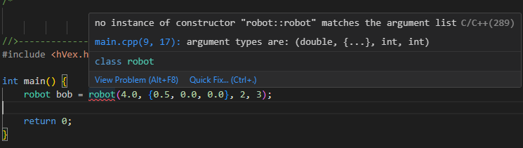

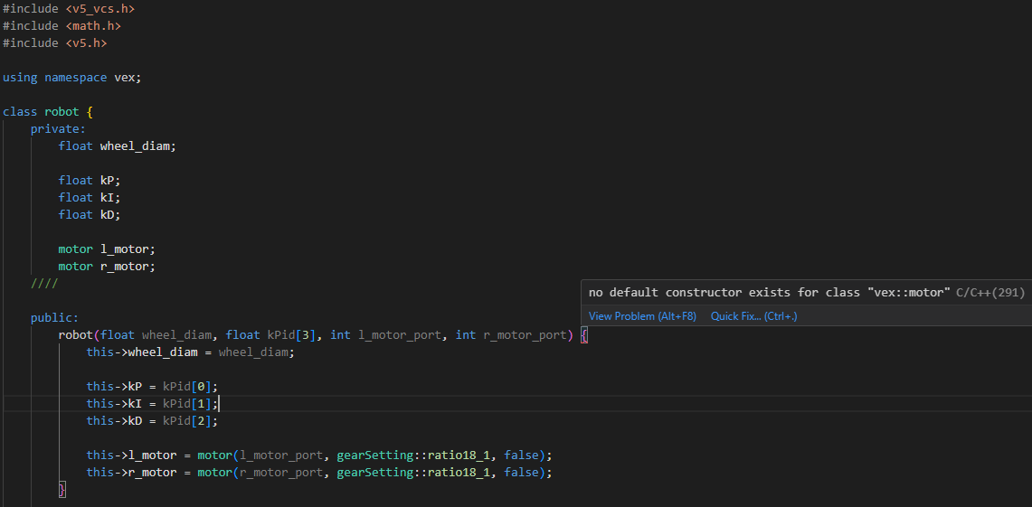

I’ve encountered a strange problem with my C/C++ Visual Studio Code project. I’ve been getting the following two errors in these two files respectively and I can’t figure out why:
hVex.h:
main.cpp:

The first issue is because as it says, vex has no default constructor for the motor class(or any of their classes for that matter). The solution I have used is to make the instance variables that are vex devices a pointer of their object type. This works great for smart port devices but does not work on analog inputs via 3-wire ports (although digital in/out ports have worked when I have tried them).
The second issue is a result of using floats instead of doubles when you made your constructor. I would recommend just changing those to doubles in your constructor (replace the ‘float’ with ‘double’). If you really really want to use float then sure by all means there is a way to but I never would unless trying to maintain cross-compatibility with C which is not important for vex v5 through VSCode.
TL;DR: Use pointers for vex devices when in a class. Use doubles instead of floats.
