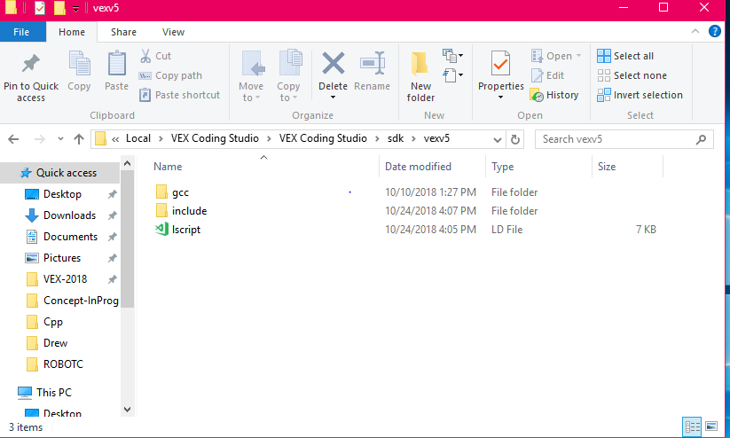

When I compile my file, make attempts to compile, but then fails with a code 1.
I have posted my makefile and error on pastebin.
I’ve never came across this error before. If I error my code though, it shows the error as normal.
Please Help
Edit 1: Fixed url
Make will fail if compiler or linker has an error, link errors don’t show in VCS 1.0 so I would check that first. Make sure you are not trying to use any variables or instances that don’t exist.
Found my problem, (I think)
In my makefile it asks for
stdlib_0.lib
, and
libv5rt.a
but I don’t have either of the files.
Would you happen to have the file (or anyone in this thread)
Thanks (:
They are installed by VCS.
I know that. I literally don’t have the files on my computer.
Close VCS. delete the Vex Coding Studio folder in the app support folder. Launch VCS and it should rewrite all the files.
