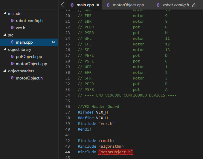

C++ VEXCode Pro - Path issue
How do you make VEXCode acknowledge other directories instead of having to go to a folder->file’s path via includes?
I’ve been going through much of the learncpp tutorials, but I am having problems make what I am trying to do work (which is to make the compiler acknowledge other directories instead of just the src and include directory).
I am unsure if recognizing other directories should be automatic within vexcode, but I’m unsure about how to make it work.

To clarify, the only way to make it include files in other directories is to explicity identify the path of said directory in every single include for a file? (Unless in src or include directory)
with this file structure

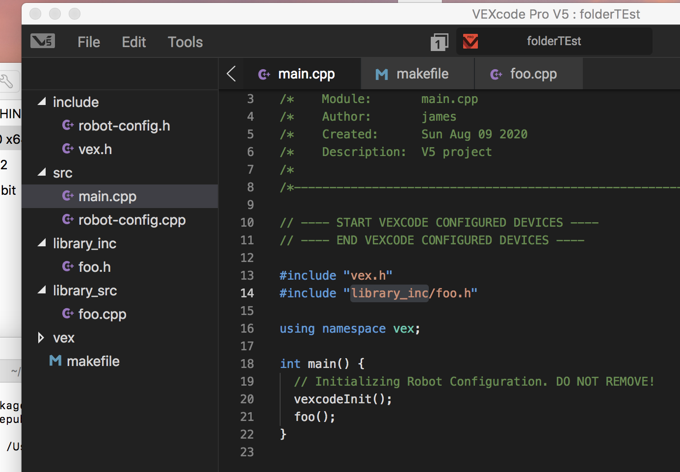

There are two issues to deal with. To keep the real time intellisense happy, use the path as I show in that screen shot. You don’t have to do that if you can put up with errors being shown by the language server in the code. The language server uses the compile_commands.json file for information on where to find include files etc. This is more or less hard coded in VEXcode and it gets generated when the project is saved. Creating it based on the actual makefiles is usually what’s done by other systems, but that is also prone to errors and often has issues with finding the source of system headers, so we just kept it simple.
To have the project build, I modified the makefile as follows.

added new locations for source and header files
specifically added these two lines
SRC_C += $(wildcard library_src/*.cpp)
SRC_H  += $(wildcard library_inc/*.h)
and modified this one.
# project header file locations
INC_F  = include .
there are alternate ways of achieving the same thing
