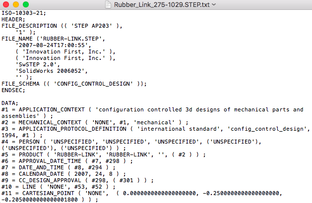

Whenever I download a CAD file from the VEX online store it downloads it as a text file? Could someone please explain to me on how I should fix this?
@Shunkansen the files download as [name].STEP.txt
You can just delete the “.txt” part from the name and that will get you your .step file
@jannis Thank you for your response. I tried that but it refuses to delete the .txt from the name
