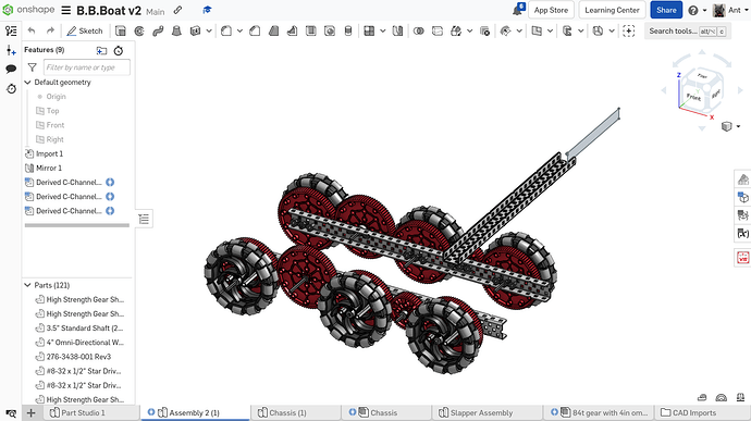

I was looking at a video and saw that the mirror function is in the part studio and our team’s left side drive train is in assembly so is there another way to do mirror or a way to get my team’s drivetrain onto the part studio because I tried to copy and paste it and it didn’t work

Never mind I found a way to do it all you have to do is export it then import it back into the document on Onshape as a Part Studio
A problem I ran into is that after I did this to mirror the drive train I wasn’t able to move it around as when it was in the assembly and wasn’t able to fasten any pieces to it I am getting more confused as I keep doing this.
Like should I just stay on assembly and make the other side of the drivetrain as is or should I export then Import it as a part studio to mirror It I am very confused

As you have found out, in Onshape you can’t make a mirror image of an assembly with a press of a button. So, for beginning users, I would recommend doing it manually. First, by duplicating the assembly you want to mirror and then making changes to that assembly until you have the mirror image.
But you have almost found a way to create a mirror. You are way ahead! Once you have the mirror in a parts studio, create a new assembly, then insert your mirrored part studio into the assembly. You should now have an assembly that is the mirror.
I did what you told me to do but the parts are not fastened so is there a way to insert it with the parts fastened or do I have to fasten them again?
Try grouping them instead of fastening.
