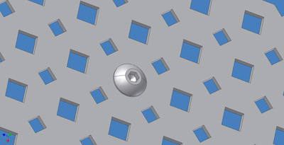

I pulled some components off of the Vex website and started to try and mate them to make a simple chassis. I find mating is kind of really tricky. Since the holes are bigger than the screws and there’s no easy way in Solidworks to find the center of a hole it was hard to constrain a bolt to them. The bearing blocks looked easier but the little square tabs are just a tad bit off the right size. So, how do you guys mate stuff quickly and easily when they don’t fit perfectly together? Any other tips or tricks I should know about?

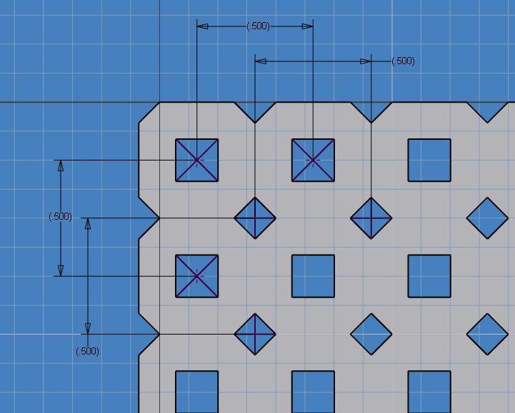

I originally discovered that none of the square, rectangular solids and cutouts that VEX designers made have axes in them. If you want to constrain a “square peg to a round hole”, (or a round screw to a square hole, or square shaft to a square hole) you have to create the missing axis, or center points in the solid. A pain, I know. It should have been done when the designers were first creating the solids, but oh well…
I had to go back, take all their parts in Inventor, or .STP format, (I work primmarily in Inventor, but am familiar w/ Pro-E & SolidWorks)
  1. make a sketch on the face perpendicular to the desired axis,
project existing geometry,
Create sketch lines that meet in the center (across corners of a square, from centers of unequal sides, etc.)
to find the geometric center,
then add a point. Add a inscribed circle also (good idea).
Pattern the sketch elements, particularly the points, circle and axis line.
Close the sketch,
start a new sketch at the other end of the proposed axis,
repeat above from (1.)

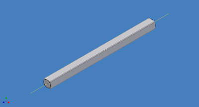

Then, add an axis along the centerline of the solid that can be used to constrain a cylindrical object (like a screw, which has built in axis) to the artificial axis that you’ve created in your square hole in the sheet metal, nylon bearing block, etc.
If it’s a patterned feature, like the sheet metal plates, c-channel, etc., just find the C to C and pattern the artificial, created axis or point.
Note: after you’ve done constraining your assembly, go back into the individual parts and turn off visibility of the "constraint construction"elements. Axis lines, sketch elements, etc.
Lots of work, but then you’ll easily and accurately be able to constrain round to square, and vice-versa.

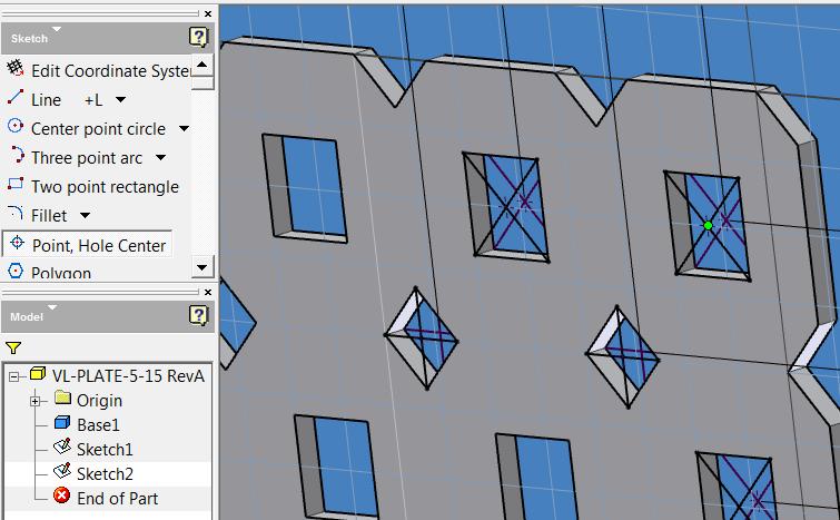

Also, for mating holes, it’s similar to what ngineer suggested, but probably simpler:
  1. Open the part for which you need an axis defined in a hole
  2. Find the desired hole
  3. Define a midplane between two parallel planes on two opposite faces of the square hole.
  4. Repeat Step 3 for the adjacent two faces that are opposite each other.
  5. Define the axis as the intersection of the two midplanes.
  6. Hide midplane visibility.

What I do is to put in one sketch to find the centre point, level with one of the faces of the metal,
close the sketch and then click on the dropdown next to “Axis” and select “Parallel to Line through Point”, then click on the point and one of the outside edges of the part, meaning you only have to do the one sketch each time…
You can then turn off the visibility of that sketch, as you won’t need it anymore - if you do want a pattern across your whole part you can just pattern the work axis itself
