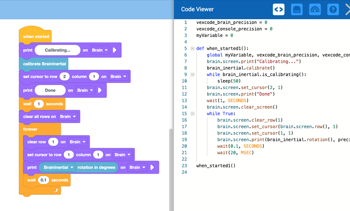

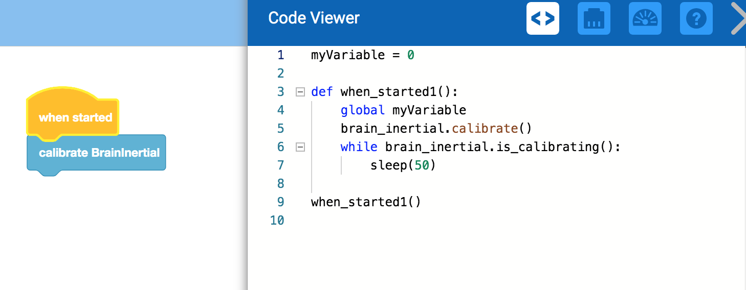

Ok, so I was slightly misleading, perhaps I mis-understood your question.
In blocks, the calibrate block will wait for completion, but does not print anything on the screen while it calibrates as when using a drivetrain.

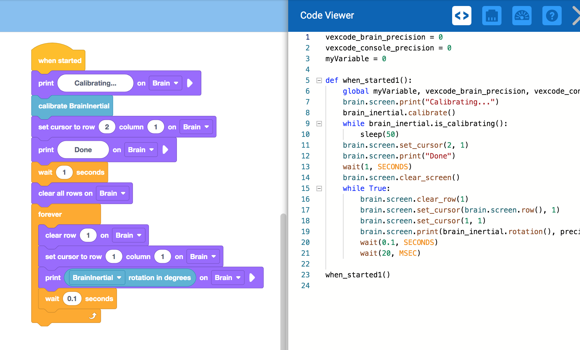

To test the inertial is woking and/or allow debug, you could have some code like this.
Thanks, I got it fixed. I misunderstood the function, and I think I confused you. I was mainly trying to figure out this weird thing, and the C++ example really helped.
