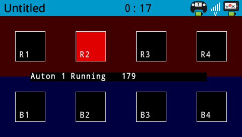

So that’s the essence of the code, to make this work for an autonomous selector you will need to change it slightly, I will post an example shortly.
#6
To make the code work for auton selection, we will change how the buttons react and make them more like a radio control group, that is, only one can be selected at a time. We create a global variable to save our selection.
// storage for our auton selection
int   autonomousSelection = -1;
The userTouchCallbackReleased function now looks like this.
/** @brief      Screen has been (un)touched                                    */
void
userTouchCallbackReleased() {
    int index;
    int xpos = Brain.Screen.xPosition();
    int ypos = Brain.Screen.yPosition();
    if( (index = findButton( xpos, ypos )) >= 0 ) {
      // clear all buttons to false, ie. unselected
      initButtons();
      // now set this one as true
      buttons[index].state = true;
      // save as auton selection
      autonomousSelection = index;
      displayButtonControls( index, false );
instead of toggling the state of the button, we set all buttons to false by calling initButtons and then set the button that was touched to true. We also save the index of the selected button in autonomousSelection.
In our autonomous function we can test the state of autonomousSelection and make decisions as to what code to run, a simple test may look like this.
void autonomous( void ) {
  int count = 0;
  while (true) {
    if( autonomousSelection < 0 )
      Brain.Screen.printAt( 60,  125, "Auton not selected  " );
    else
      Brain.Screen.printAt( 60,  125, "Auton %d Running %5d", autonomousSelection, count++ );
    task::sleep(100);
so attached is an updated version that looks like this

In the example that James Pearman posted, you can only select one button at a time. So at most 8 options that can picked one at a time.
You can configure the button label you wish.
What you might do is something like this:
else
  Brain.Screen.printAt( 60,  125, "Auton %d Running", autonomousSelection );
switch(autonomousSelection){
    case 0:
        allianceColor=0;    // RED
        startTile=0;        // NEAR
        doPark=1;           // PARK
        shootPreload=1;     // SHOOT PRELOAD
        break;
    case 1:
        doPark=0;           // NO PARK
        break;
    case 2:
        break;
    case 3:
        break;
    case 4:
        break;
    case 5:
        break;
    case 6:
        break;
    case 7:
        break;
Shoot ball
if(shootBall){
Not optimal, so you might want to change the behavior of the buttons in button released procedure so that the state of any button is maintained and not set to false… This way you get more than eight possibilities.

#17
@mvas8037 When i put that example as an else if function underneath my autonomous void it came up with errors even though your logic behind it is crystal clear
#18
Here’s a snippet of text from our code to get you guys started:
int count = 0;
while (true) {
else if(autonomousSelection == 0){
Brain.Screen.printAt( 60,  125, "Red Autonomous, Flags + Caps Selected" );
Intake.startRotateFor(-5000,rotationUnits::deg,100,velocityUnits::pct);
#19
@mvas8037 Thanks for everything
#20
@mvas8037 As you can tell I’m pretty new but i was wondering how i decide to run more than one if i used
int count = 0;
while (true) {
else if(autonomousSelection == 1){
Brain.Screen.printAt( 60, 125, “Red Autonomous, Flags + Caps Selected” );
Would that default to the first box
