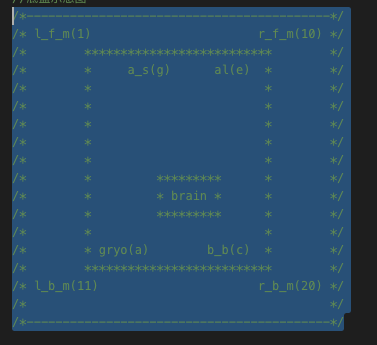

Hi , I meet a problem. can anyone finger out which wrong.
Enviroement: V5
Motor: 4-wheel
My code:
main.cpp

Problem:
1.drive_train.stop(); invoked , the joystick will not work.
2.if i comment drive_train.stop(); the joystick can controller forword & back ,but not turn left & right.
thanks.
