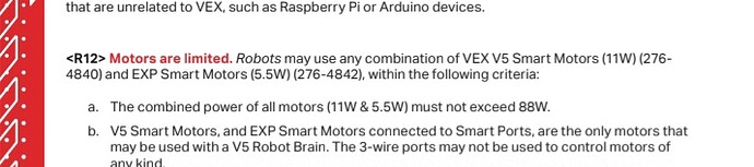

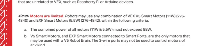

R12 States:
Motors are limited. Robots may use any combination of VEX V5 Smart Motors (11W) (276-4840) and EXP Smart Motors (5.5W) (276-4842), within the following criteria:
  1. The combined power of all motors (11W & 5.5W) must not exceed 88W.
  2. V5 Smart Motors, and EXP Smart Motors, connected to Smart Ports, are the only motors that may be used with a V5 Robot Brain. The 3-wire ports may not be used to control motors of any kind.

No. If it is functional, since it exceeds the 88w limit, it would be illegal. Also, can someone explain if the motor has to be connected to the brain? (The rule doesn’t say yes, but kind of infers it by saying “connected to smart ports”)

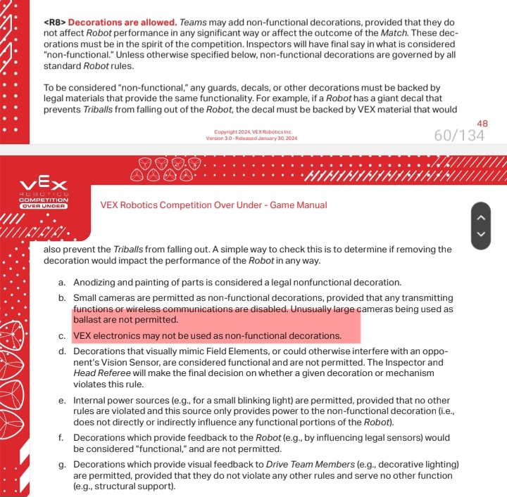

If it is not functional, it still isn’t allowed since it is banned from being a non-functional decoration.
