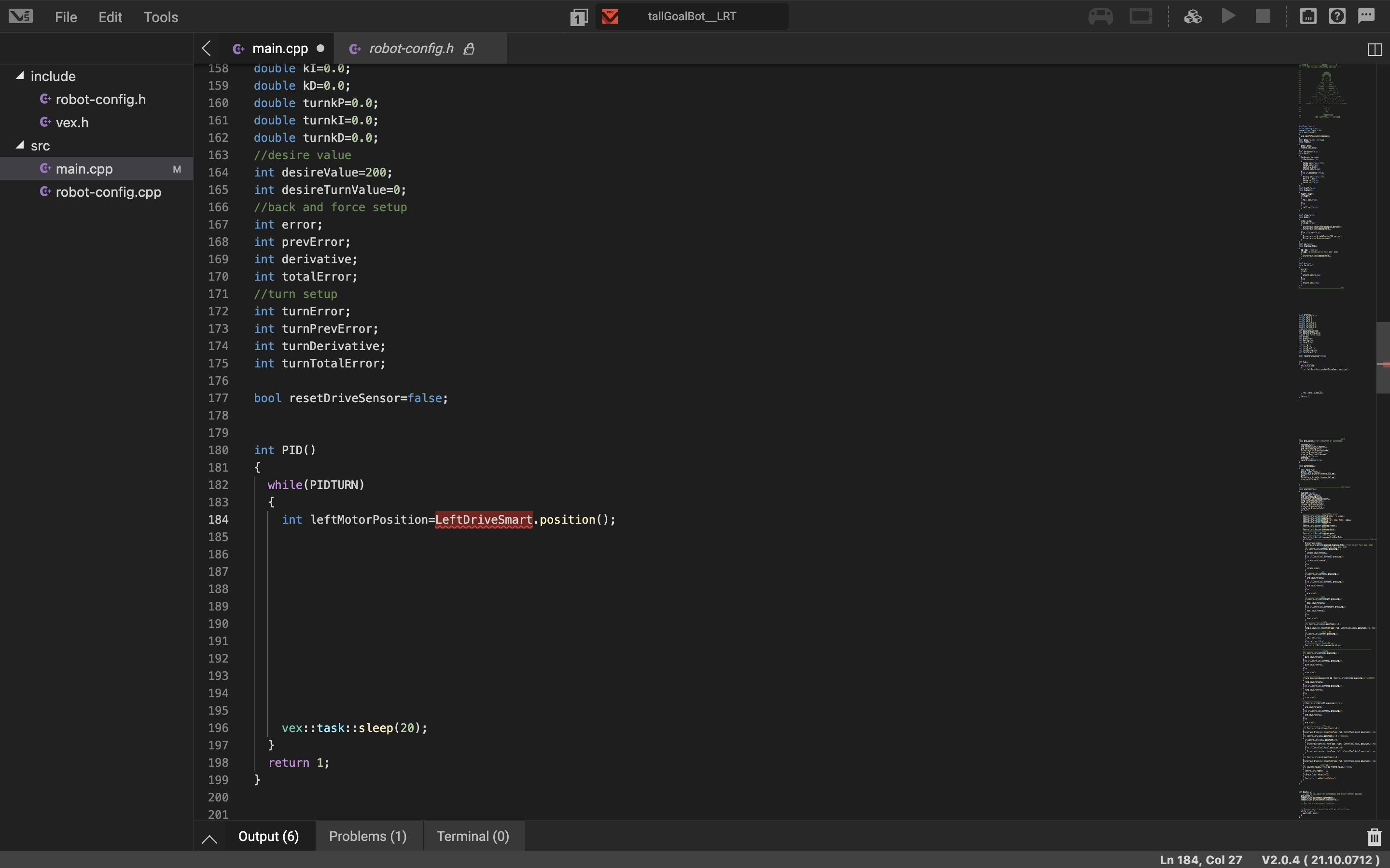

Can I write PID if I use the function of drivetrain in VEX IDE
As you guys know, PID requires each motor of the drivetrain. BUT, How can I know the position of each motor if I use the drivetrain function in VEXcode pro v5?
Need some help!
Also, do running an PID requires any sensor?

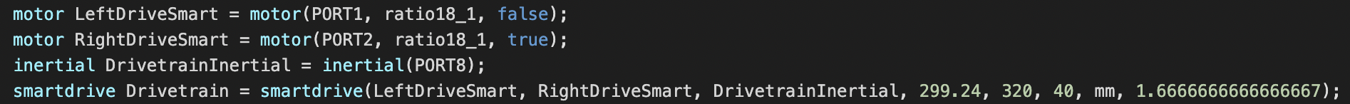

If you look in the robot-config.cpp file, you can see that vexcode internally creates motor objects for the drive motors. However, these motors are not included in robot-config.h and therefore not accesible in main.cpp. To fix this, add extern motor LeftDriveSmart; and extern motor RightDriveSmart; in main.cpp. This lets the program know that these motor objects are defined elsewhere, and it will know to use them when you try to get its position.
