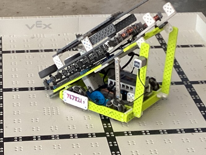

Number 3: Pintex: It uses a 180 degree claw that can flip pins over and place them onto a beam. (A claw in the back is also used to pick up a beam.) It is a simple build but is more difficult to drive.

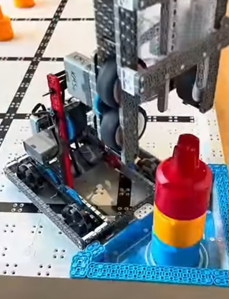

Number 4: Pinhead: Pinhead uses a large intake consisting of tires that have a good grip on the pin. These tires boost the pin up to the top of a compartment that stacks a stack from the bottom. The Intake is also connected to a 4-bar lift that is used to place the pin back down onto a goal or on the field.
