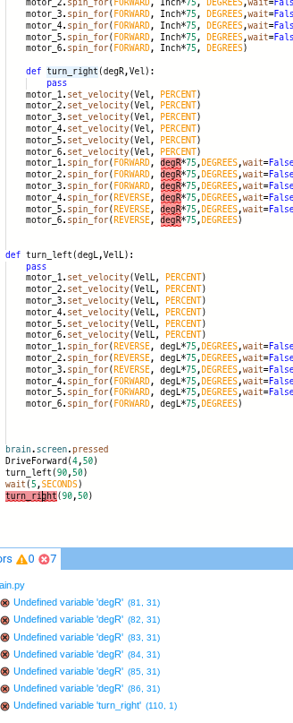

Can someone tell what I did wrong here
Bad indentation. It doesn’t see degR for those motor commands because they are not in the function.
all the lines in the function need to be indented, and if the functions don’t run then, try removing the pass
