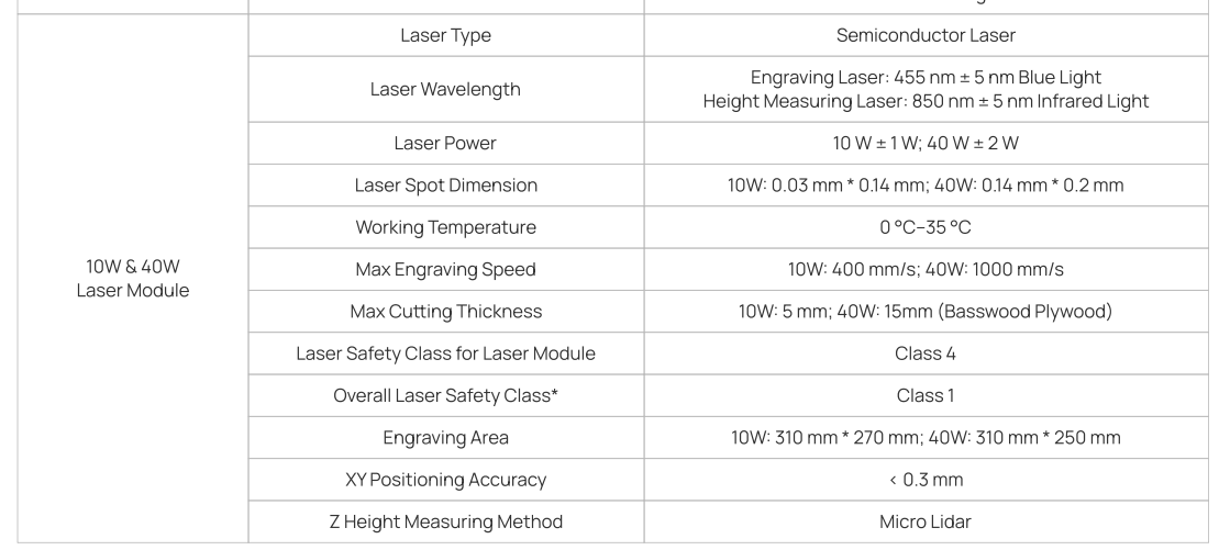

Can this cut plastics for VEX?
Bamboo Labs is coming out with a new printer that has a laser. I’m curious if this could be used to cut the plastics we use for VEX.
Yes, it probably could. I think the 10W laser probably will cut 1/16" plastic stock, but it will probably go slow and need multiple passes. The 40W is probably a better bet for cutting plastic.
My biggest reservation with going with this Bambu is you have a pretty small working surface for cutting (about 12" x 10") Most parts you would probably cut for VEX robots will fit within that size, but you are going to need to break down your raw material in order to fit it in the machine to cut. The more you have to break down your material, the more waste you will eventually have.

The 10W is $600 extra and the 40W is $1,400 extra. I didn’t think about keeping everything clean.
