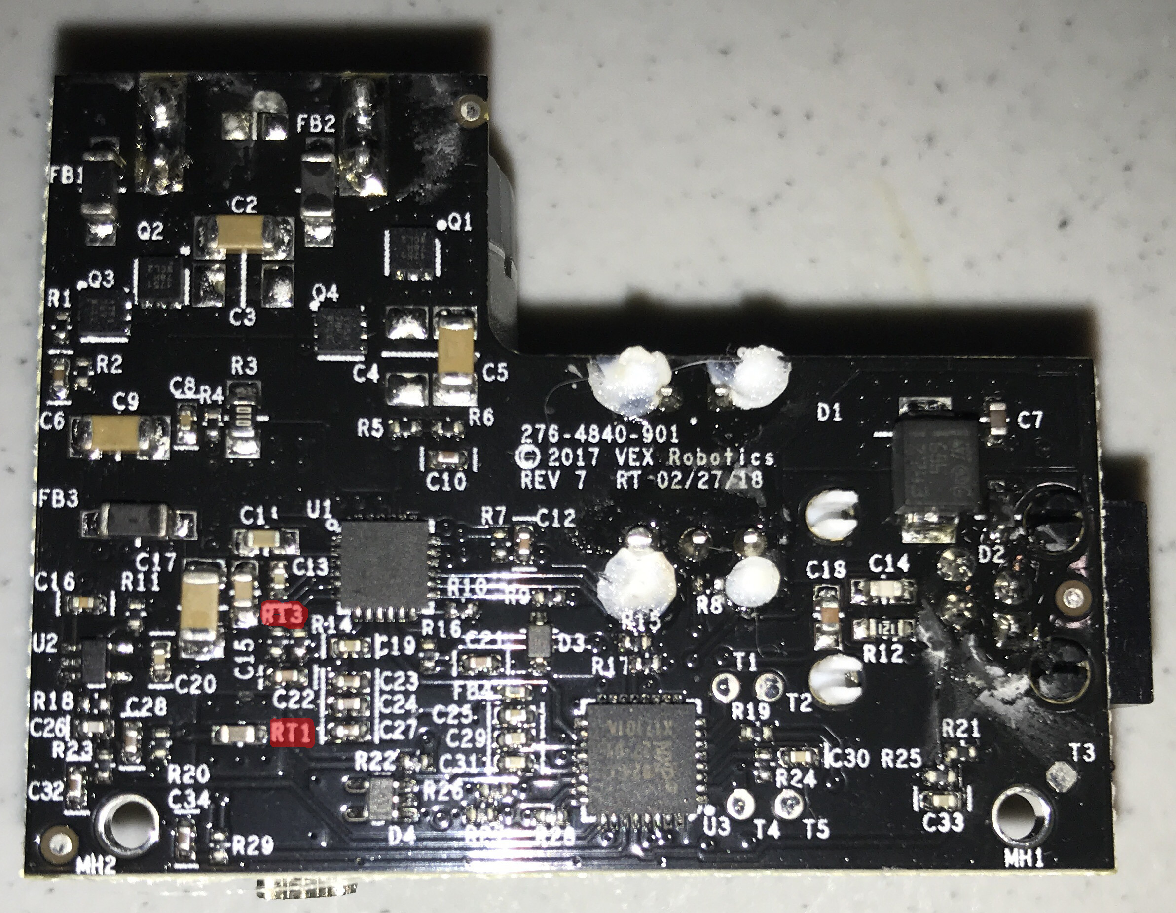

Hello!
Still new to this, not an electronics guru, just a “shadetree mechanic” type who got drafted into this from teaching history, because I’m a “shadetree mechanic” type…
Anyway - I’ve got a V5 motor that just quit on us one day during practice. The red LED at the port doesn’t light up, the brain won’t detect it, nothing - tried on different ports and brains - nothing.
No idea what’s really happened, but here’s what I did, and what I noticed: after taking it apart and looking very closely at the circuit board, I noticed something - on the “elevated” part of the circuit board, there are two very small rectangular black components, with silver ends on the narrow ends. On the board, they are labeled “FB1” and “FB2” , Each is just to the left of where each power lead to the motor is soldered to the board. FB2 has some white discoloration on the surface, which can be scratched off with my fingernail. My instincts are telling me that this component has overheated or shorted, and burned out - but I’m not trained in solid-state electronics, so I don’t know for sure.
My questions: does anyone have any idea what happened to my motor, and can it be fixed?
What IS “FB2”, and what does it do?
Is FB2 my problem? If so, where does one get a replacement?
Am I being too anal about trying to save $50 for my school team?
Thanks to all!!

Google says FB generally stands for “Ferrite Bead”, and that they generally behave similarly to inductors. If I had to guess with the motor light not turning on at all, it’s possible that the DC motor itself is shorted internally. You could try swapping it with a motor form a known good motor (at the slight risk of damaging the good DC motor) and seeing if the board powers up. If it doesn’t, then it’s probably some component on the PCB, which IMO is going to take way more time than its worth to reverse engineer and fix. That is, unless you enjoy such projects, in which case please post your findings here on the forum, I’d love to know more about the motor electronics!

I guess, you are talking about the components in the top left part of the motor PCB:

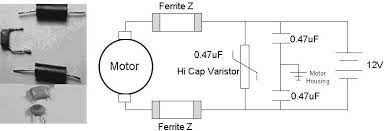

And, as @sazrocks said, those are likely ferrite beads connected like in this diagram (source) to supress EMI noise from the brush/commutator contact bounce of the DC motor.
ferrite-bead-motor-protection
If you suspect that FB2 acted more like a “Fuse Block” than a “Ferrite Bead” you can, first, unplug the DC motor from PCB and then try to spin it by hand.
If it spins easily and doesn’t feel like something rattles or is broken inside, then you can measure resistance between its terminals and, if there is no obvious short, try to connect it to a 9V battery, and see if it runs.
Then you can measure resistance of the FB1, FB2, and FB3 components on the board. If the theory that FB2 is burnt out is correct, than resistance of FB1 and FB2 should read close to zero, while FB2 reads open circuit.
If the motor is still under warranty, you can always ask VEX support about replacement options, otherwise…
VEX is unlikely to give us any specs on the unmarked parts, so if your school is planning to compete in VRC and you believe in right to repair, then I would save this motor in a special box to be used later for harvesting any usable parts to repair other motors in the future.
If this is for classroom use only, your school is tight on budget, and you are not afraid of soldering, then…
No light of any sort may be an indication that something else got damaged during a short circuit event (i.e. crushed motor brushes).
After disconnecting the DC motor from PCB you can open up another working motor, connect them both to a V5 brain and start measuring and comparing voltages (vs ground wire) at various points on the PCB.
This could lead you to discover if any diode, resistor, or voltage regulator along power route is damaged.
Burnt ferrite bead, diode, resistor, or capacitor would be relatively easy to replace, rather than other more complex active elements in the absence of schematics.
