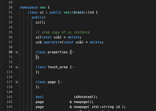

For a graphics class, you can subclass just the lcd class of the brain, no need to access other things like SD card and timer, for example, here is a snippet (with some of the internal code folded up) from an internal program we have that implements some additional UI like functionality on the screen. The ui class is a subclass of vex::brain::lcd
an instance of that class, lets say it’s called “ui” can access normal drawing functions.
ui.setPenColor(white);
ui.setFont( mono15 );
as well as additional functions we add.
ui.drawRoundRectangle( t.xpos, t.ypos, t.width, t.height, 4, cola );
look up C++ inheritance, you will find lots of examples.
