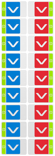

Can you add turning point flags to your robot?
With turning point now over I have realized that they flag is made out of clear plastic. I was wondering if you could put that in your robot for decoration or to be a working part of the robot.
Though they aren’t currently allowed, your best bet would be asking the q and a when it releases.
Why not?
< R9 > A limited amount of custom plastic is allowed. Robots may use non-shattering plastic from the following list; polycarbonate (Lexan), acetel monopolymer (Delrin), acetal copolymer (Acetron GP), POM (acetal), ABS, PEEK, PET, HDPE, LDPE, Nylon (all grades), Polypropylene, FEP; as cut from a single 12” x 24” sheet up to 0.070” thick.
a. Shattering plastic, such as acrylic, is prohibited.
b. Plastic may be mechanically altered by cutting, drilling, bending etc. It cannot be chemically
treated, melted, or cast. Heating polycarbonate to aid in bending is acceptable.
I don’t think they are the right thickness, but I could be wrong. Also since the colors are the exact same as alliance colors it might be a violation of < R12e> which talks about vision sensor interference.
Definitely a Q&A question.
You aren’t allowed to use competition products or apparel on your robot, so it’s illegal until clarified by the q and a
Edit: it is stated in the clarification for R5
0.065" as I measured, so within legal tolerances.
I would normally agree, but the game elements aren’t red or blue this year. The green from the flag is the only thing I’d be worried about.
