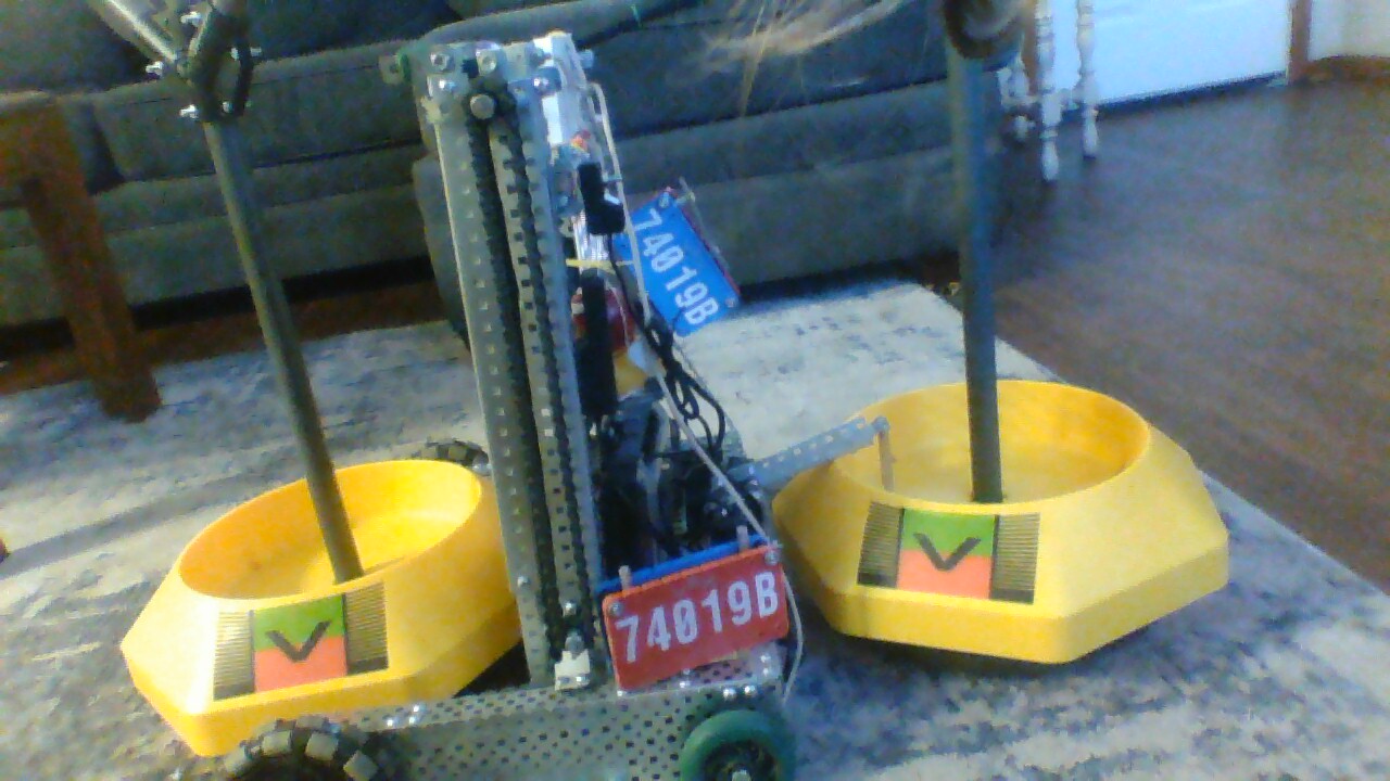

Can you legally hoard 1 goal when already in possession of 2?
i have a bot that can lift up a goal and hook one with a hook/claw on the back. if i have a goal on my forklift and one hooked behind me, and were to push one into a corner and stay there, is it hoarding? also can both you and your team memeber have possiession of a goal and hoard 1 goal and it not be a penalty? thank you!
sorry im not at my lab right now but just wanted to show if my claw can be considered possiesion.

Possession – A Robot is considered to be in Possession of a Mobile Goal if the Robot is carrying, holding or controlling the movement of a Mobile Goal such that if the Robot changes direction, the Mobile Goal will move with the Robot. Therefore, pushing/plowing Mobile Goals is not considered Possession, however a Robot using concave portions to control the movement of Mobile Goals is considered Possession. See Figure 18.
Provided the hook is actually able to be used to drag the goal around, it will be considered possessed, meaning you could push a third goal into a corner and hoard it, so long as you do not let go of either of the other goals.
