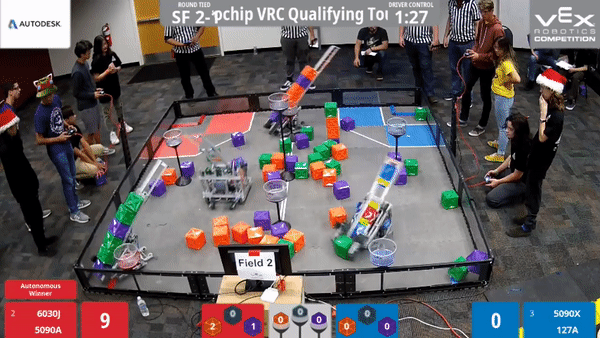

So what I’m hearing is that this is now illegal? I did like this manuver…
ezgif-6-4bb4f5bafa32
This just killed most dr4b strays for playing defense over there. This just reinforces the tray meta and makes it more about getting that full 10-12 stack in that corner instead of sacrificing a cube or 2 to actually put the stack up
It seems it goes against the knocking cubes out and ramming them into the barrier so idk if this would actually be a dq or not
It would most certainly be a dq now. Both because they’re purposefully pushing cubes out of the field (the cubes have nowhere else to go) and because the offensive robot is touching the barrier.

What @Sylvie posted is indeed illegal, but it is not necessarily a DQ. That would depend on whether it was match affecting, how many warnings the team had previously, etc.
It would be VERY hard to determine if something like that is match affecting, especially if it happened early in the match. Who is is say that that team wouldn’t have scored a massive amount of points using towers if they were able to get that stack up?
I would say that Ref’s should be erring on the side of the offensive robot here and unless the match was completely one sided otherwise, this would almost always be match affecting. Use this defensive strategy at your own risk!
