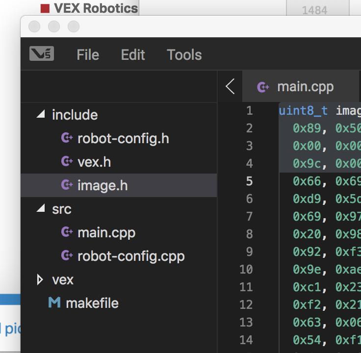

Can you upload picture/gif to brain without sd card?
You need to turn the image (png or bmp) into a C struct and then display that using the drawImageFromBuffer function. We do not directly provide any tools to do this, but it is fairly easy using tools available online, this is one way, there may be others available as well.
Images must be less than 480x240 pixels in size or they will not display. In general this method should only be used for smaller images as it will make the program much larger.
Go to the LVGL image converter page.
Although we are not using LVGL in VEXcode, it can still convert to the necessary data format.
Convert the PNG image using these settings.
This will download to your PC a C file with the data, however, we have to make a few changes to it before we can use it.
  1. rename the file so it has a .h rather than a .c extension.

Now create a VEXcode project. With the project open, move or copy the image data file into the include folder. You should see something like this in VEXcode now.
Add the image.h (or whatever it is called) header into main.cpp and display like this.
(only include these image headers in exactly one .cpp file, do not include in main.cpp and another file or the project will not build).
