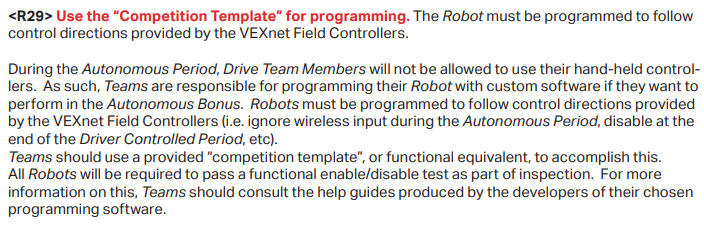

Can you use ANY python modules
If you use python to code your robot, can you import any module?
Are there specific ones allowed to be used?
There are no rules against it. Note: “Your chosen programming software.”
