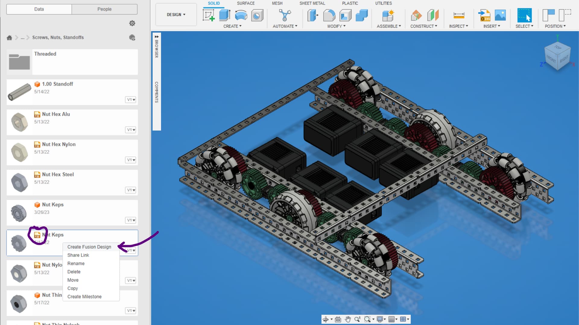

You could try the following steps:
first right click the .f3d part you want to insert and choose Create Fusion Design:
After doing this, you will end up with another part file, but the difference is that now you can insert your part without dragging. (see next step)
After your new file has been created you can now right click this new file (the file icon should be different now; an orange cube), and select Insert Into Current Design:
Selecting Insert Into Current Design should insert this new part into your current design.
I realize that this is a very roundabout way of solving your problem, but it is the only thing I can think of at the moment, hope this helps! :slight_smile:

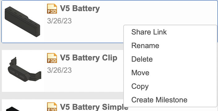

Yes, but not exactly. the part you select can’t be a .f3d file; the option doesn’t appear for that type of file… see my post.

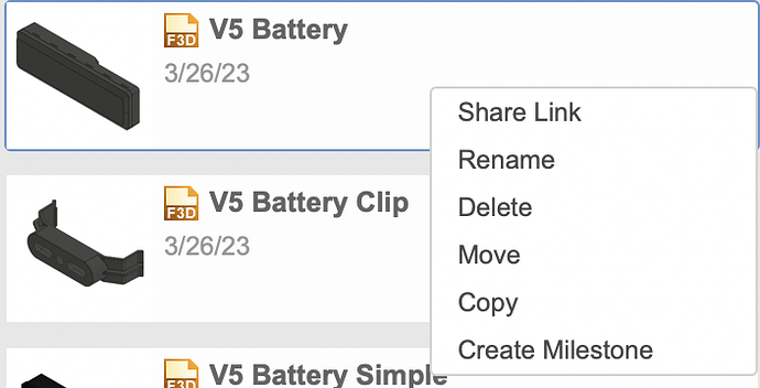

this is whats happening and I don’t think I am getting the option
i just found the solution myself LOL, I was uploading the entire lib on the fusion hub website, but if I upload the files in the fusion app like 1 by 1 and make them editable then it can be inserted.
